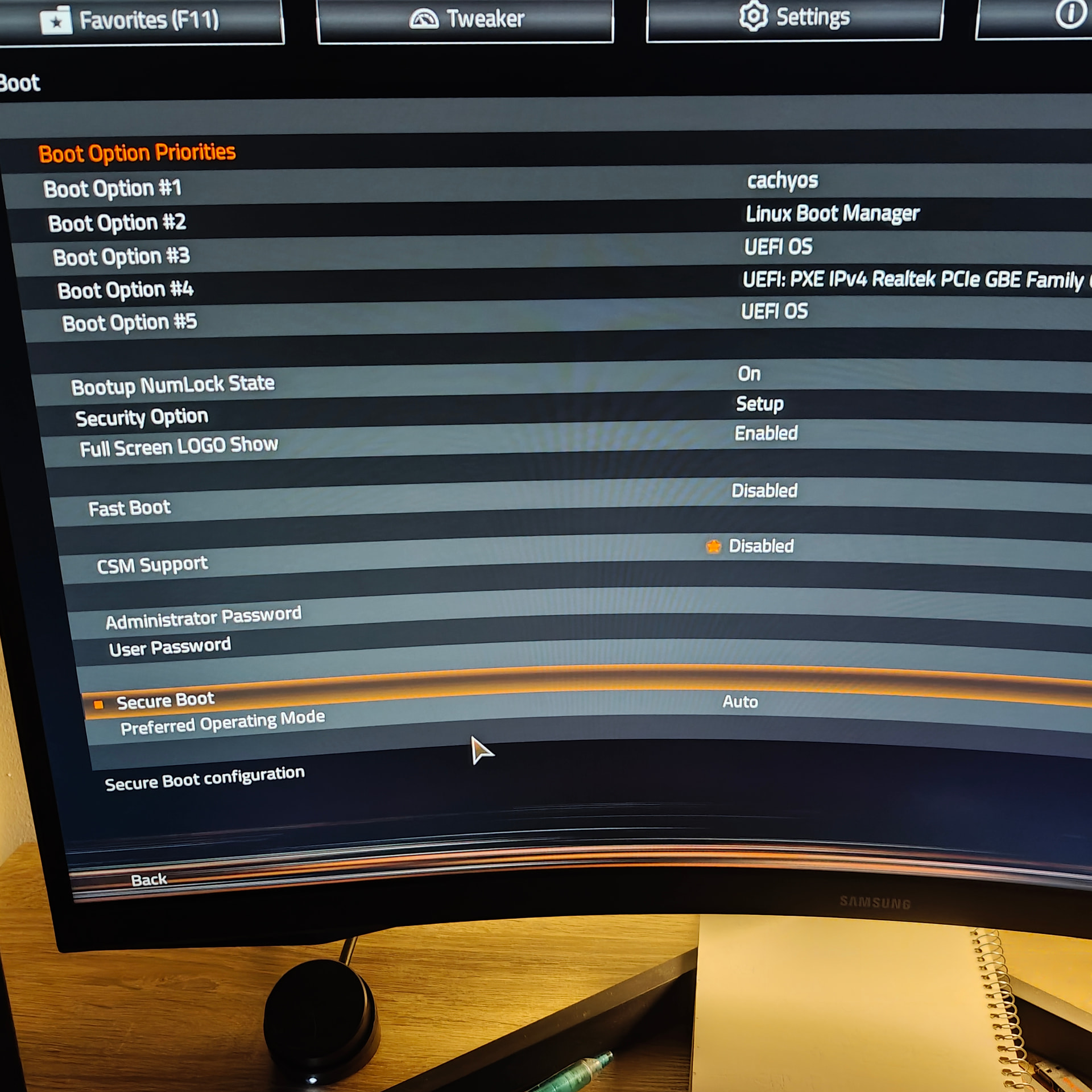

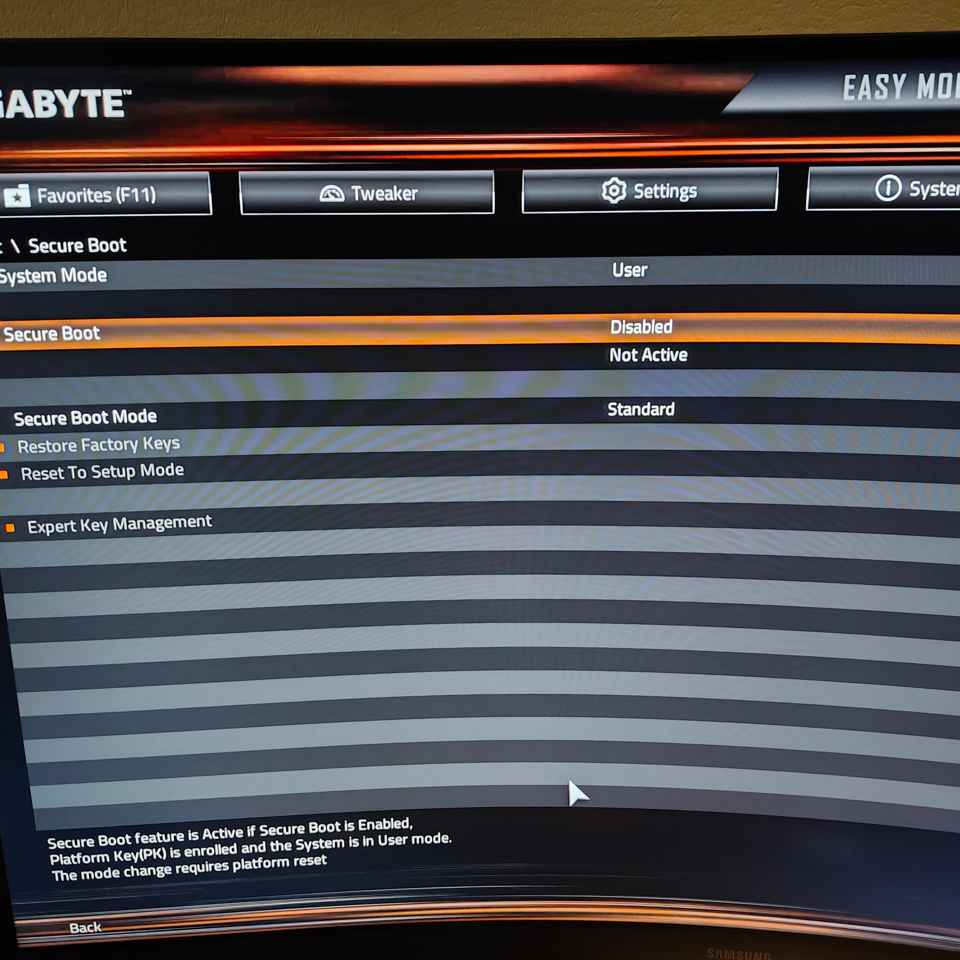

Ok. yes that might be it but i looked in my pcs bios and the secure boot even if i disable it stands on auto mode and i don’t know how to disable it and i dont want to mess up my bios so it gets unstable

i got cachyos as main and endeavor os on separate 1 tb nvme ssd disks. but want to find another instead of endeavouros since they are both arch
Just a FYI. If you are unsure if your computer has secure boot on or not you should be able to type mokutil --sb-state on the command line (terminal) and it will tell you.
I just tried the command and mokutil command could not be found. but i think its on as it stands in auto mode
