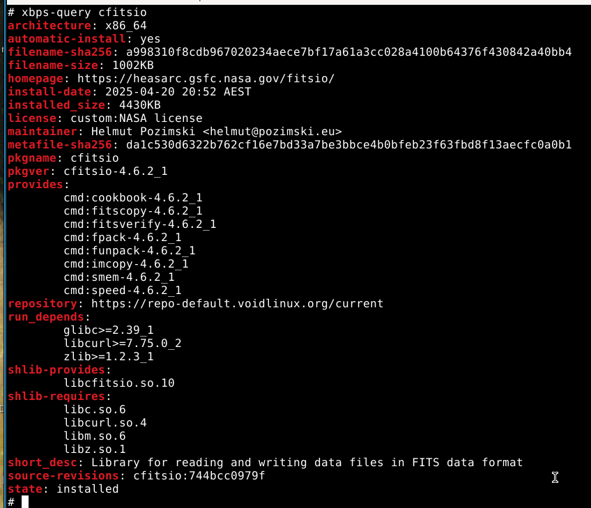

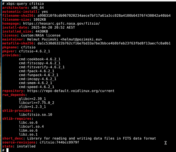

smem is not installed, cfitsio is installed.
I think it must be trying to install smem, and it clashes with cfitsio?
My gut feeling is to remove cfitsio. I have no idea what that might break?
Looks like cfitsio uses smem-4.6.2_1 and the package system is trying to install smem-1.5_3.

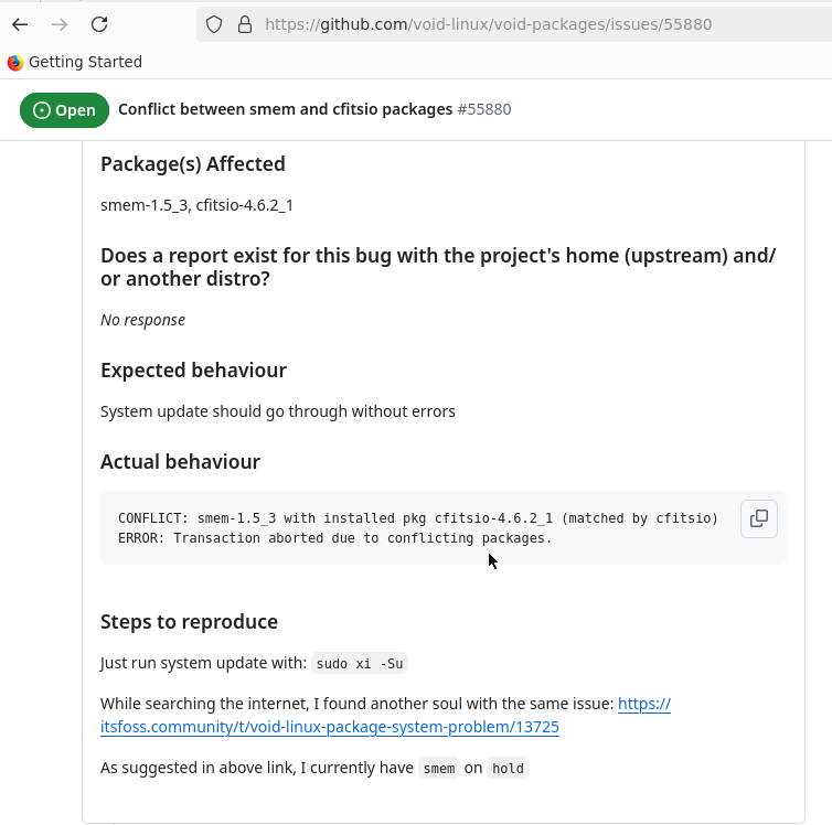

I think I need to prevent a system update from installing smem
# xbps-pkgdb -m hold smem
# xbps-install -Su

I think the problem is that cfitsio has a subcommand called smem . It is getting that confused with the smem package.

I suspect it may be part of cfitsio because cfitsio has a subcommand called smem, because…
That is the original message while attempting an update…cfitsio is involved somehow.
The only package that requires cfitsio is gimp… if I delete cfitsio gimp will stop working.

The packages cfitsio-4.6.2_1 and smem-1.5_3 clash, by installing smem-1.5_3 I have made it impossible to install gimp
It is a package system bug. I shall report it.
Meanwhile, I can do without gimp, so I leave it like it is and Void will be able to update.
The bug has been reported to Void
Ok, so there’s a bug report already, great. I assume it’s quickly corrected. If you don’t need gimp just wait for the fix.

As far as my limited understanding goes I also think this is a genuine package conflict in the Void Linux repository, perhaps a packaging bug.
There seems to be no user-side workaround available and no simple workaround (neither hiding nor deleting /usr/bin/smem) will help. :worried:
So it really seems that it is for the Void Linux maintainers to fix the packaging so the conflict is resolved.
