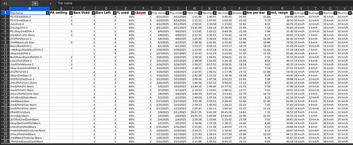

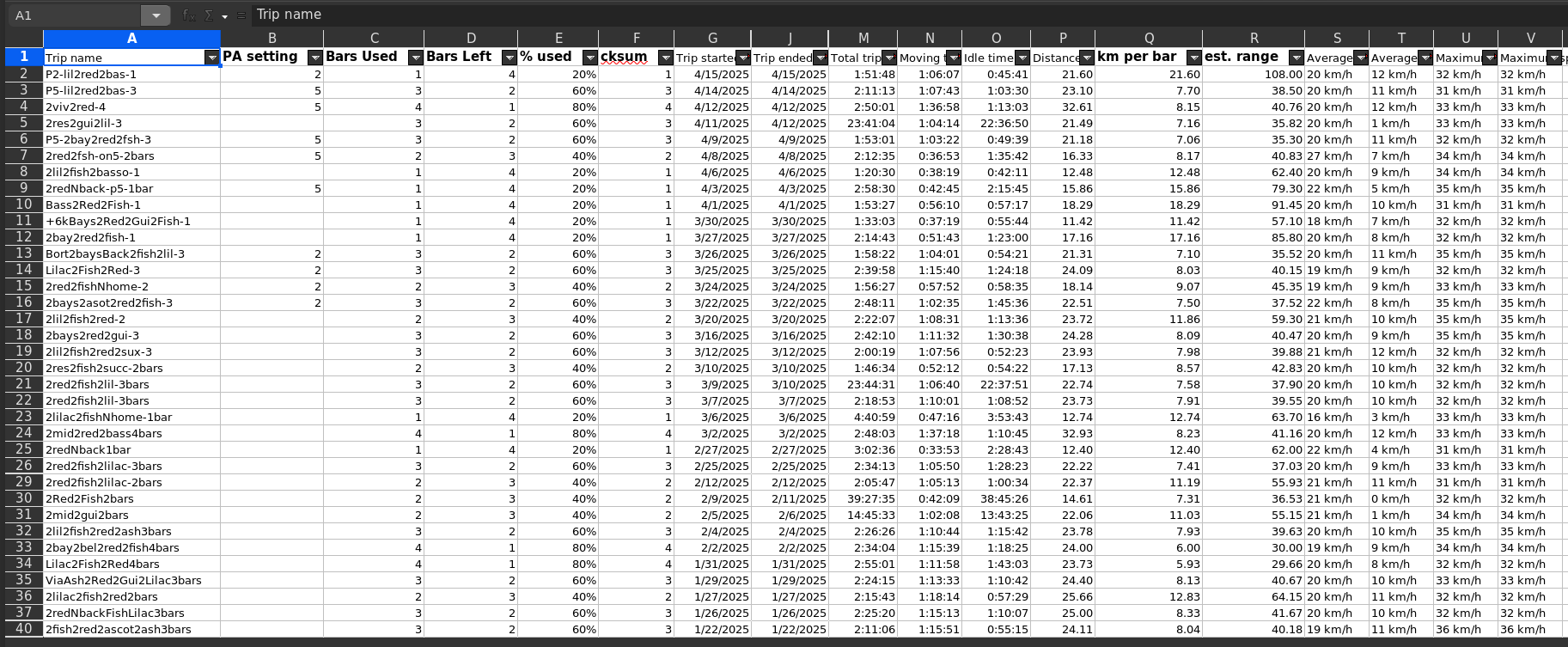

This is good - this is progress - I can work with this data now… I’ll probably do some more tweaking - e.g. replace the string “Latitude,Longitude” with something like “GPS”
sed 's/Latitude,Longitude/GPS/g' ff.txt
I’d rather not do all this tweaking by hand in a Word Processor or a spreadsheet - because I’ll be grabbing new data off my phone constantly… Then also remove empty columns (“,”) :
sed -i 's/,,/,/g' ff.txt
This is mostly scriptable and repeatable… Which was what I wanted…
I can then do some more tweaking e.g. take out those names and make a header row… But that’s a lot of strings to manage… But now it’s in columns - I might be able to use “cut” which I haven’t used for a couple decades now…
OK - figured out how to remove the field names from the body :
sed 's/Trip name,//;s/Trip started at,//;s/Starting GPS,//;s/Trip ended at,//;s/Ending GPS,//;s/Total trip time,//;s/Moving time,//;s/Idle time,//;s/Distance,//;s/Average speed (Moving),//;s/Average speed (Total),//;s/Maximum Speed,//;s/Maximum speed (Original),//' ff.txt
I didn’t realise you could do that with sed (i.e. multiple “nested” string replaces with semi-colon)…
So now I can load this into LibreOffice Calc and makes some guestimates based on km travelled, battery bars used, and anticipated range :
I’ll probably just keep using that spreadsheet file when I get new rows of data to append…
BTW - a couple of those estimates look wildy optimistic : e.g. the top row of 108 km - I don’t believe that for a minute… There’s some exponentially decreasing battery remaining process that chews up more battery, the less battery, you have left…
