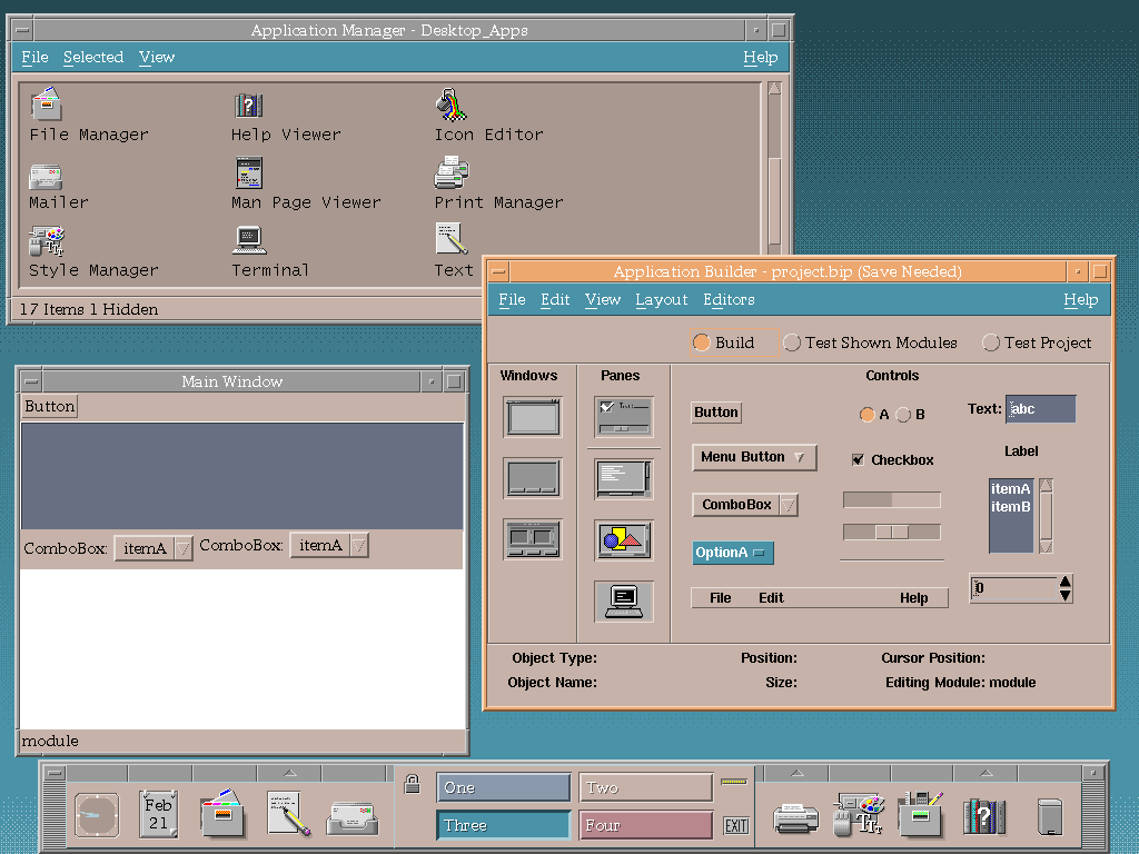

You can install a desktop on a server later… or you can disable a DE on destkop to make it a headless server… Many of those UNIX servers ran XDM (X Display Manager) by default - but not the full GUI - many ran what was called CDE if you logged into the XDM graphical login prompt :
But XDM itself didn’t use a lot of resources - and you could leave it running on a server without impacting the headless server daemons it was hosting… Nearly the same thing on Linux…
