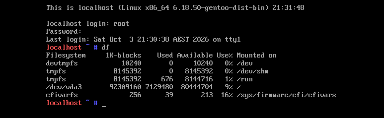

It boots .
The login ( as root) works
I have not even given it a hostname yet … hence localhost.
No X11 , No DE, no user.

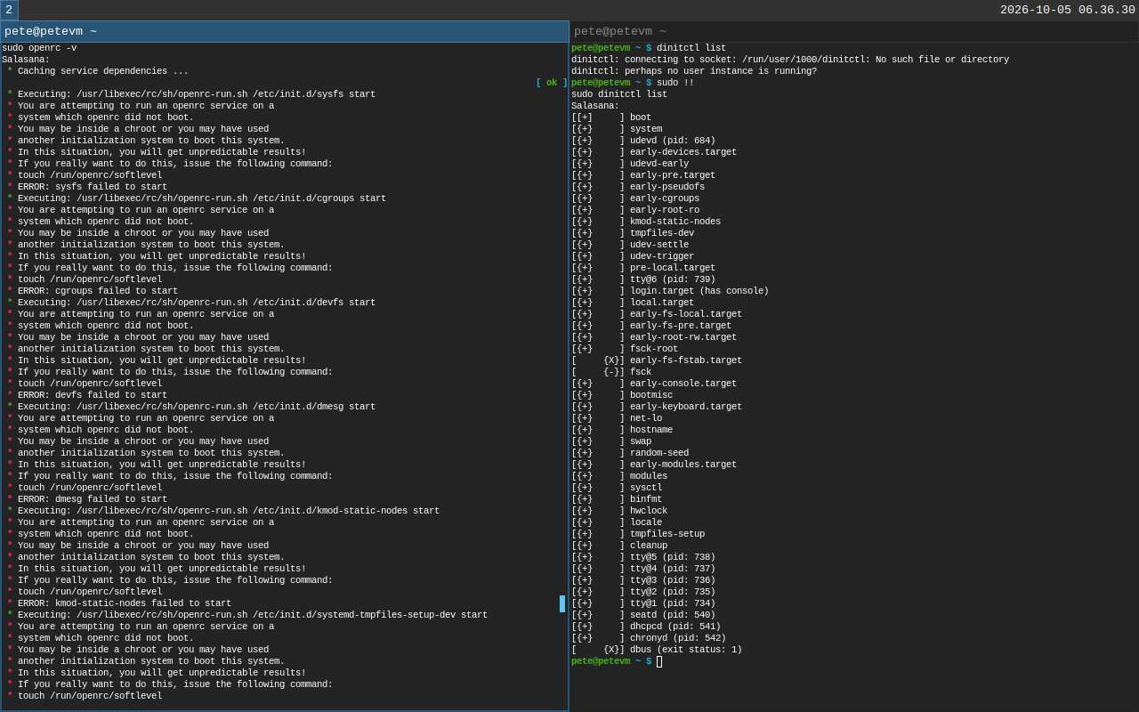

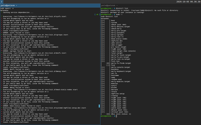

/etc/init.d is there also. OpenRC is not running.

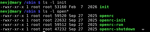

Have a look in /sbin
You will see init
Is it an executable or a link ?
  • if it is an executable it is dinit … renamed init
  • if it is a link, it will point to the dinit executable… called dinit (or maybe dinit-init)
    and there may also be an OpenRC executable ( dont know what it would be called) , in which case you could move the link to point at it, and you would be back to booting with OpenRC. (it would work because the init.d dir is still there)

Take care … init is not the same as openrc-init?
I think init is the sysVinit init , and openrc-init is the alternative init supplied by OpenRC.
The man page says this
To  use openrc-init configure your boot loader to invoke it or symlink it
       to /sbin/init.  Also, you will need to use openrc-shutdown(8),  to  halt,
       reboot or poweroff the system.
This is what is looks like BEFORE you install dinit. … I think when dinit is installed 'init` becomes a link.
I wanted to sort this out before I installed dinit.

pete@petevm ~ $ ls -l /sbin/init
lrwxrwxrwx 1 root root 5 30. 9. 17:52 /sbin/init → dinit
pete@petevm ~ $ ls -l /sbin/open*
-rwxr-xr-x 1 root root 59600 26. 7. 17:42 /sbin/openrc
-rwxr-xr-x 1 root root 22712 26. 7. 17:42 /sbin/openrc-init
-rwxr-xr-x 1 root root 55952 26. 7. 17:42 /sbin/openrc-run
-rwxr-xr-x 1 root root 43216 26. 7. 17:42 /sbin/openrc-shutdown
-rwxr-xr-x 1 root root 976760 20. 9. 17:28 /sbin/openssl
-rwxr-xr-x 1 root root 23064 5. 7. 17:30 /sbin/openvt
