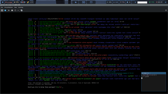

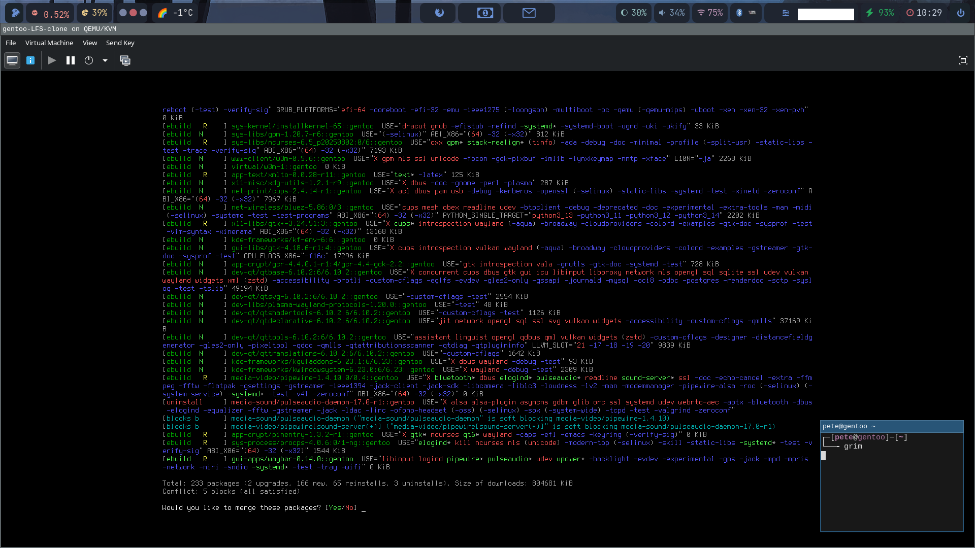

this is off topic already but I started testing how to change the init in my gentoo vm. I chrooted into gentoo then eselect profile set # (chose desktop without systemd), then edited make.conf -systemd. Then ran emerge -avuND –with-bdeps=y @worldworld. It gave error for tiff (needed to edit package.use for it) and now its running full world rebuild. Don’t know if this will work but its just an vm..
edit: it didn’t work. There’s blocked packages, many packages require systemd. Need to think :smiley:

I don’t mind if my vm wont boot so I did a “bad” thing: emerge -C systemd and after that use=”-systemd elogind” emerge -uND @world
Now it is updating 180 packages.

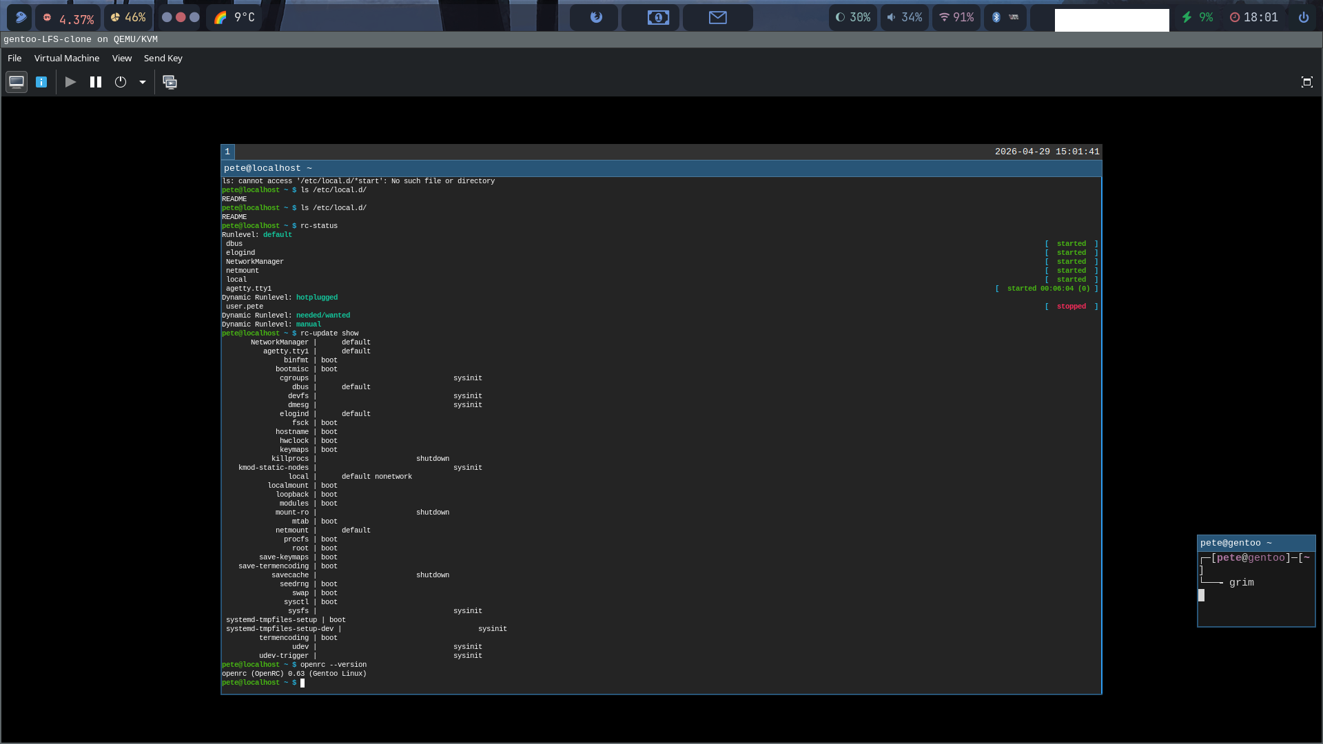

Thanks! I got the init switch almost ready. It boots and starts OpenRC now but login is a bit of an issue. Maybe there’s still some SystemD stuff and it mess with login. I’ll chroot later to the Gentoo and try to fix it. Anyways OpenRC is starting and powering off nicely

My OpenRC is running but it’s not working properly yet. Here’s my laptop’s rc-status:
rc-status
Runlevel: default
dbus [ started ]
ufw [ started ]
NetworkManager [ started ]
acpid [ started ]
avahi-daemon [ started ]
bluetooth [ started ]
dnsmasq [ stopped ]
chronyd [ started ]
cupsd [ started ]
display-manager-setup [ started ]
netmount [ started ]
display-manager [ stopped ]
laptop_mode [ started ]
libvirtd [ started ]
piavpn [ started ]
power-profiles-daemon [ started ]
spice-vdagent [ stopped ]
local [ started ]
agetty.tty5 [ started 00:14:51 (0) ]
agetty.tty1 [ started 00:14:51 (0) ]
agetty.tty2 [ started 00:14:51 (0) ]
agetty.tty6 [ started 00:14:51 (0) ]
agetty.tty3 [ started 00:14:51 (0) ]
agetty.tty4 [ started 00:14:51 (0) ]
Dynamic Runlevel: hotplugged
user.pete [ started 00:14:47 (0) ]
Dynamic Runlevel: needed/wanted
virtlogd [ started ]
Dynamic Runlevel: manual
rc-update show
NetworkManager | default
acpid | default
agetty.tty1 | default
agetty.tty2 | default
agetty.tty3 | default
agetty.tty4 | default
agetty.tty5 | default
agetty.tty6 | default
avahi-daemon | default
binfmt | boot
bluetooth | default
bootmisc | boot
cgroups | sysinit
chronyd | default
cupsd | default
dbus | default
devfs | sysinit
display-manager | default
display-manager-setup | default
dmesg | sysinit
dnsmasq | default
elogind | boot
fsck | boot
haveged | boot
hostname | boot
hwclock | boot
keymaps | boot
killprocs | shutdown
kmod-static-nodes | sysinit
laptop_mode | default
libvirtd | default
local | default nonetwork
localmount | boot
loopback | boot
modules | boot
mount-ro | shutdown
mtab | boot
netmount | default
piavpn | default
power-profiles-daemon | default
procfs | boot
root | boot
save-keymaps | boot
save-termencoding | boot
savecache | shutdown
seedrng | boot
spice-vdagent | default
swap | boot
sysctl | boot
sysfs | sysinit
systemd-tmpfiles-setup | boot
systemd-tmpfiles-setup-dev | sysinit
termencoding | boot
udev | sysinit
udev-trigger | sysinit
ufw | default
I got emerge –emptytree ready and emerge –depclean found 80 more packages to remove. Needed to add these files to get the systemd junk off:
cat /etc/portage/package.use/no-systemd
sys-apps/systemd -systemd
sys-apps/gentoo-systemd-integration -systemd
sys-apps/systemd-utils -systemd
sys-apps/dbus -systemd
sys-fs/mdadm -systemd
gui-apps/waybar -systemd
sys-kernel/installkernel -systemd
virtual/logger -systemd
#enable elogind for packages that support it
sys-auth/pambase elogind -systemd
sys-auth/elogind -systemd
net-misc/NetworkManager elogind -systemd
media-video/pipewire elogind -systemd
sys-auth/polkit -systemd
pete@localhost ~ $ cat /etc/portage/package.mask/no-systemd
sys-apps/systemd
So its doable. You need to eselect profile set [3] default/linux/amd64/23.0/desktop (stable) *
because I first tried the profile [7] default/linux/amd64/23.0/desktop/plasma (stable) and it didn’t work. Now reboot.
EDIT: Reboot and all ok.
