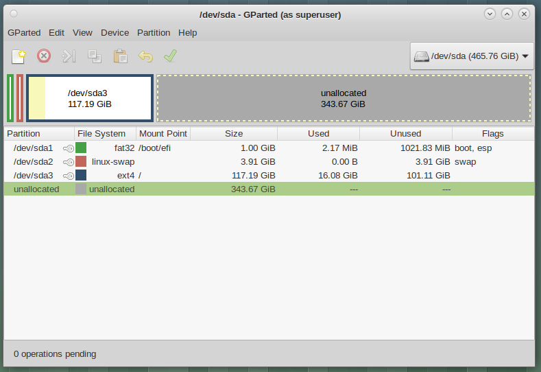

Why not? It makes grub simpler when you have an EFI partition.
Or are you legacy booting?
I would use UEFI boot wherever possible.
UEFI just complicates, especially with LFS, with more packages to compile!!!
