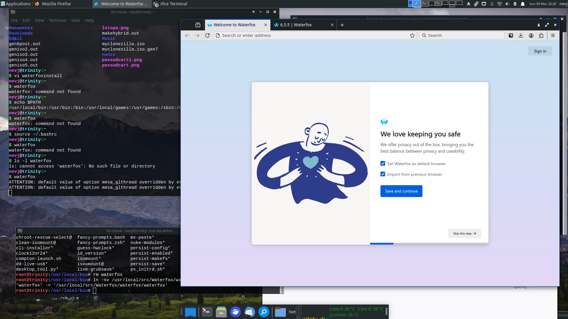

4. Run it
$ waterfox
ATTENTION: default value of option mesa_glthread overridden by environment.
When you get to step 4 your screen will look like the following
That is the welcome screen of the Waterfox browser.

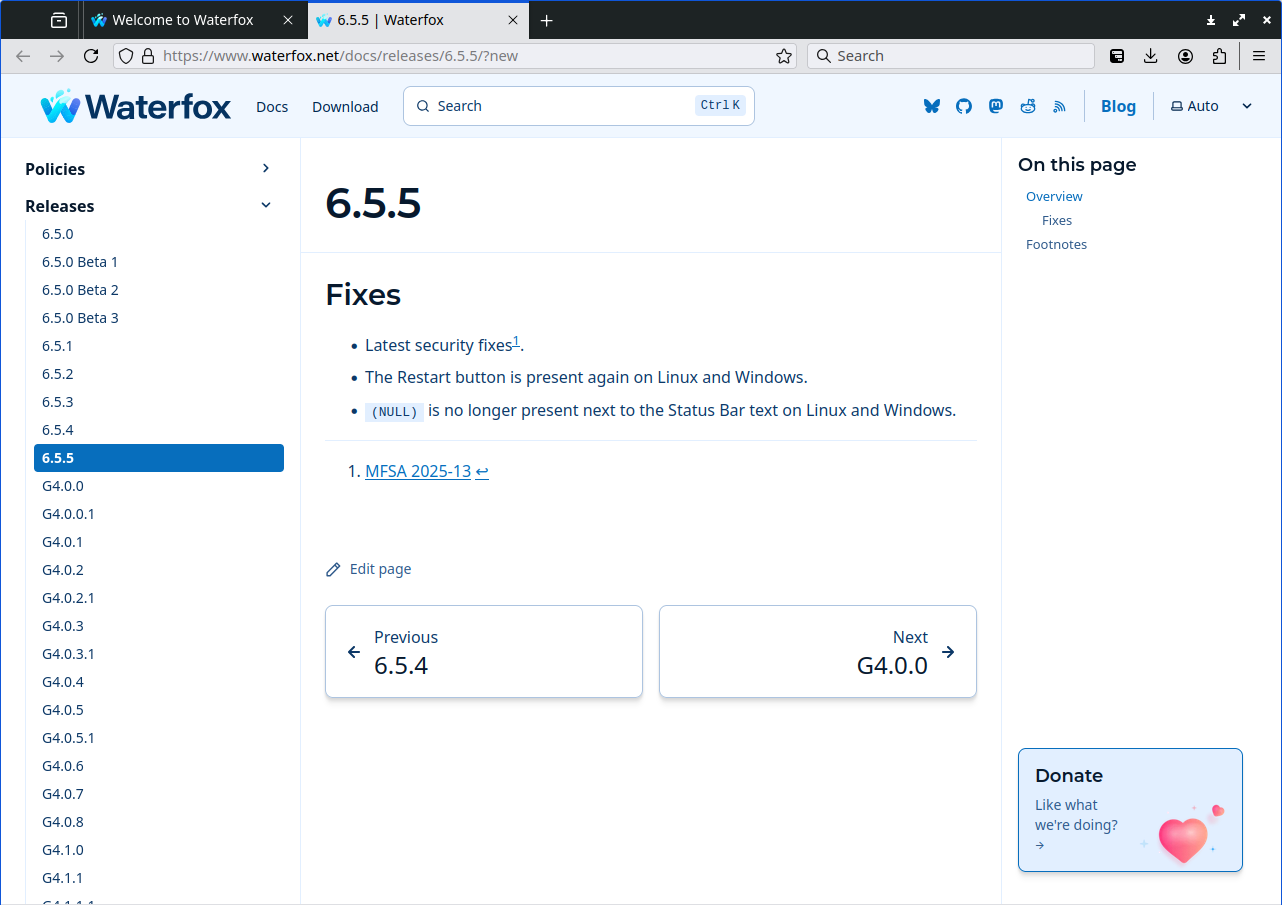

The second tab looks like this
That is another place you can download from.
All versions are available, the current version is 6.5.5

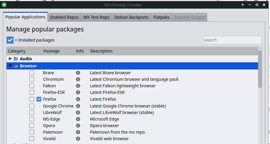

Yes, that is what I did… It is not in MX repos.

MX23 has a wide range of browsers
but not Waterfox.

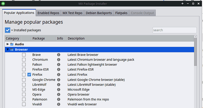

Did you check the Flatpak tab? I installed it on my MX from there. On Linux Mint (it is not in the repo) I did as you did and downloaded tarball and installed via CLI. I did not do anything else, but when I tried the menu and typed WAT, it appeared in the start menu. Strange.

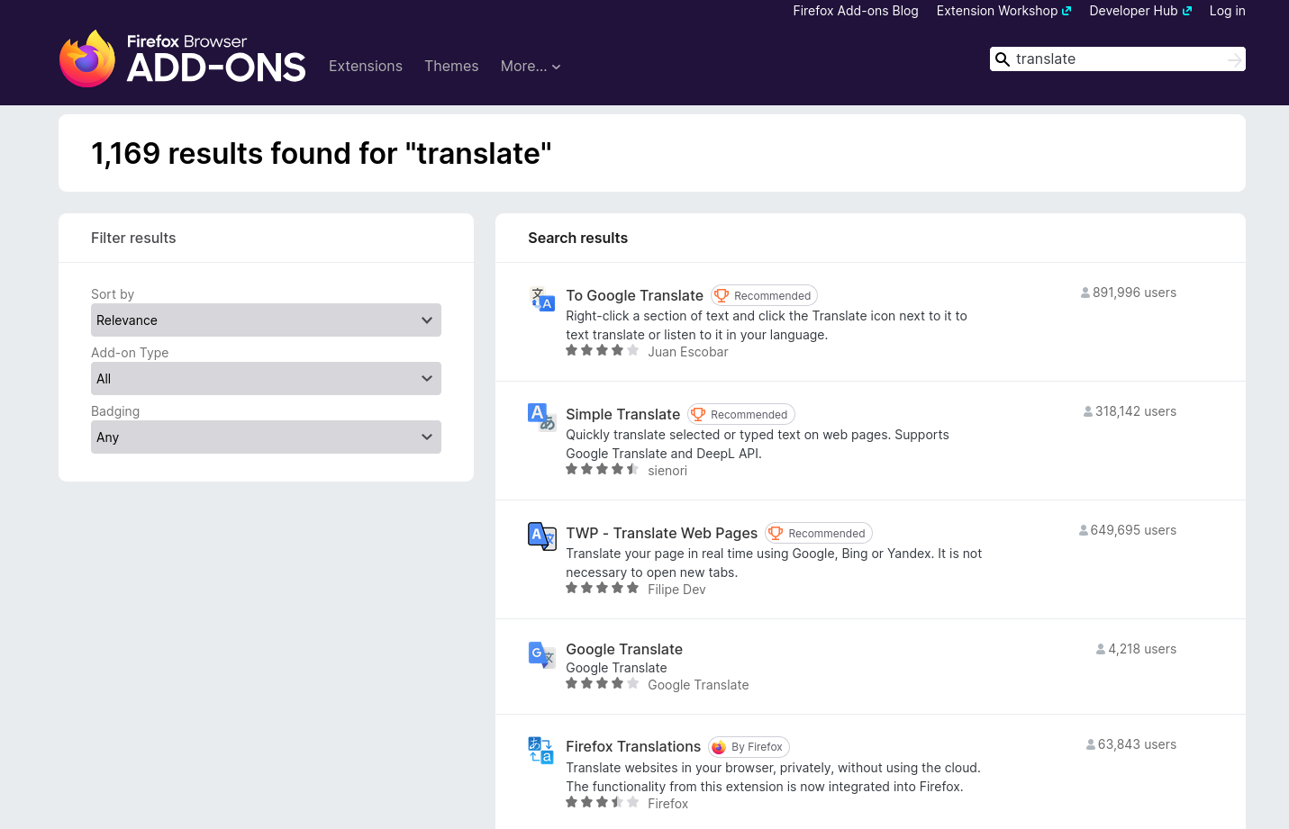

The only thing to me that was strange, and I know little about these things, but everything was related to Firefox, confirmed extensions were from Firefox, etc. Themes were from Firefox. Searching for an extension for “translate”
It opened a new tab in Waterfox and showed FF extensions. Otherwise, I am happy with it for now.
