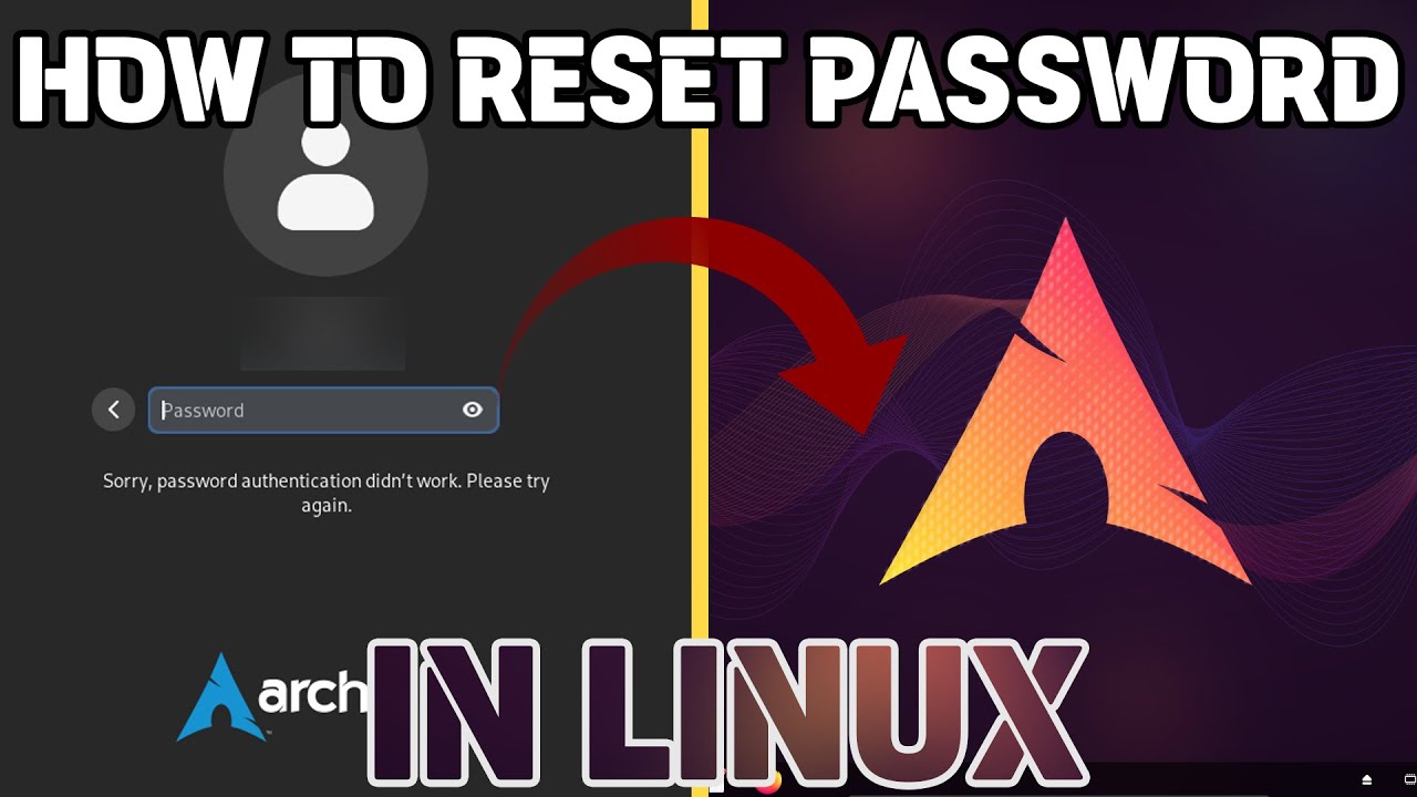

I can't log in although i typed the correct password on Arch Linux
I changed my password in boot " " or “abcd”
But it still can’t be log in
Help me guys im new..

I followed this turtorial to change my usr password

I changed password again but it still “sign in failed”…
I set the password is “s” in case wrong keyboard input but it still error…
