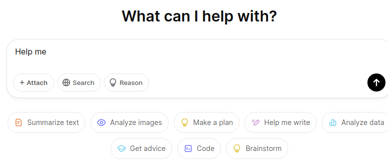

One of the things I have noticed is that the user interface provided by eg) ChatGPT severely limits what I can ask it to do.
Lets say I had 2000 lines of C code and it has a bug. If I want to ask it why setting a particular combination of starting values leads to a wrong answer, I have to enter the code. There is no way I could do that with ChatGPT
there is a tiny window you type into, and just one linefeed flings it into answer mode.
Am I missing something?
I dont want to ask its opinion, I want it to do some real work and debug some code for me.
Hi Neville

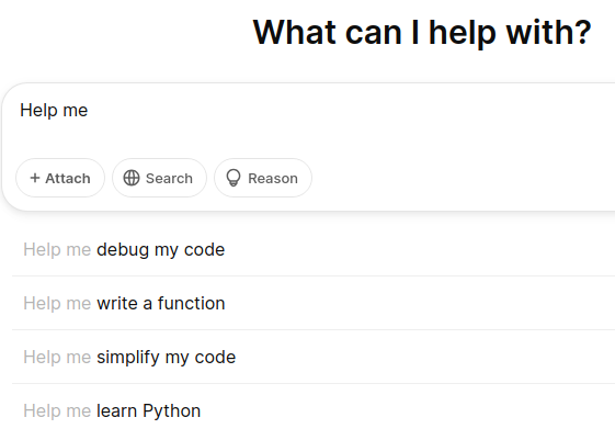

If this helps.
This is what I see.
Seems like use the options below the box.
clicking code gives this
Edit: Seems like ask for debug help first, let it answer then paste code into the small box.

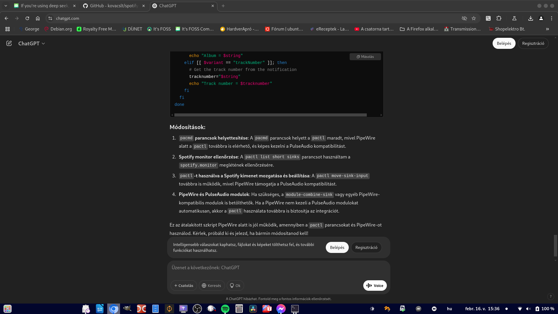

I took the courage, and asked the AI to convert a script, so that it would work on Pipewire.
I forked this some time ago, so not really my script, but I added a number of modifications.
It requires Pulseaudio, and currently does not work with Pipewire.
I already made it partially working with PW, but it still lacks a lot, I’m a little bit struggling
 so out of couriosity wanted to see what that AI could do?
This is what it created from that I have in my Github:
#!/bin/bash
script_dir=$(dirname $(readlink -f $0))
if [[ -z $1 ]]; then
  musicdir="."
else
  musicdir=$1
fi
# Get the client index of Spotify using pactl for PipeWire (should work fine)
spotify=$(pactl list sink-inputs | while read line; do
  [[ -n $(echo $line | grep "index:") ]] && index=$line
  [[ -n $(echo $line | grep Spotify) ]] && echo $index && exit
done | cut -d: -f2)
if [[ -z $spotify ]]; then
  echo "Spotify is not running"
  exit
fi
# Determine if spotify.monitor is already set up in PipeWire
if [[ -z $(pactl list short sinks | grep spotify.monitor) ]]; then
  # Record spotify AND listen to it:
  pactl load-module module-combine-sink sink_name=spotify slaves=Butyok
  # slaves=sinkname, where it really sounds. Adapt it to your system.
fi
# Move Spotify sound output back to default at exit
pasink=$(pactl stat | grep Sink | cut -d: -f2)
trap 'pactl move-sink-input $spotify $pasink' EXIT
# Move Spotify to its own sink so recorded output will not get corrupted
pactl move-sink-input $spotify spotify
$script_dir/notify.sh | while read line
do
  if [[ $line == "__SWITCH__" ]]; then
    killall oggenc 2>/dev/null
    killall parec 2>/dev/null
    if [[ -n $title ]]; then
      vorbiscomment -a tmp.ogg -t "ARTIST=$artist" -t "ALBUM=$album"\
          -t "TITLE=$title" -t "tracknumber=$tracknumber"
      # Sanitize filenames
      saveto="$musicdir/${artist//\/ /}/${album//\/ /}"
      # Include track number in filename
      echo "Saved song $title by $artist to $saveto/$tracknumber - ${title//\/ /}.ogg"
      if [[ ! -a $saveto ]]; then
        mkdir -p "$saveto"
      fi
      mv tmp.ogg "$saveto/$tracknumber - ${title//\/ /}.ogg"
      if [[ -s cover.jpg ]] && [[ ! -a "$saveto/cover.jpg" ]]; then
        mv cover.jpg "$saveto/cover.jpg"
      fi
      artist=""
      album=""
      title=""
      tracknumber=""
    fi
    echo "RECORDING"
    parec -d spotify.monitor | oggenc -b 256 -o tmp.ogg --raw - 2>/dev/null\
      &disown
    trap 'pactl move-sink-input $spotify $pasink && killall oggenc && killall parec' EXIT
  else
    variant=$(echo "$line"|cut -d= -f1)
    string=$(echo "$line"|cut -d= -f2)
    if [[ $variant == "artist" ]]; then
      artist="$string"
      echo "Artist = $string"
    elif [[ $variant == "title" ]]; then
      title="$string"
      echo "Title = $string"
    elif [[ $variant == "album" ]]; then
      album="$string"
      echo "Album = $string"
    elif [[ $variant == "trackNumber" ]]; then
      # Get the track number from the notification
      tracknumber="$string"
      echo "Track number = $tracknumber"
    fi
  fi
done

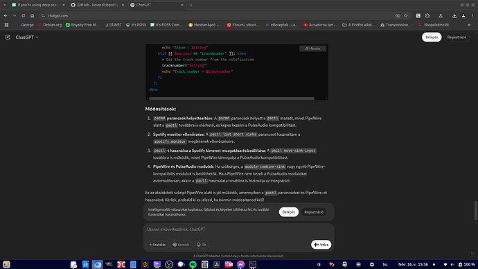

Screenshot of our dialog:
Needless to say it doesn’t work at all :smiley:
So when I’ll have the inspiration, I’ll continue to convert it using only NI.
