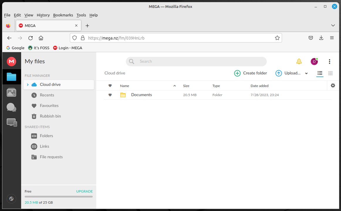

UPDATE: Have no idea what this result means, but I went to Mega on W11 on my laptop and connected while on the Verizon hotspot. Then I reconnected to home network and turned off the VPN on the router and Mega logged in and started fetching file list and is now about 30% through that. LM still connected to Verizon and fetching files 60% complete.
VPN has always been on router except for a few times when I couldn’t get to a certain website, I’d turn it off then back on after that site. So again, did Protonmail server issue affect my network in such a way that the VPN began blocking Mega, cause Protonmail has continued to work with VPN on all this time.
UPDATE: LM Mega fetched the file list and upon completion brought up that window I keep mentioning asking for full sync or partial and LM notified Mega is now syncing. W11 on laptop completed file fetch and is now running/syncing.

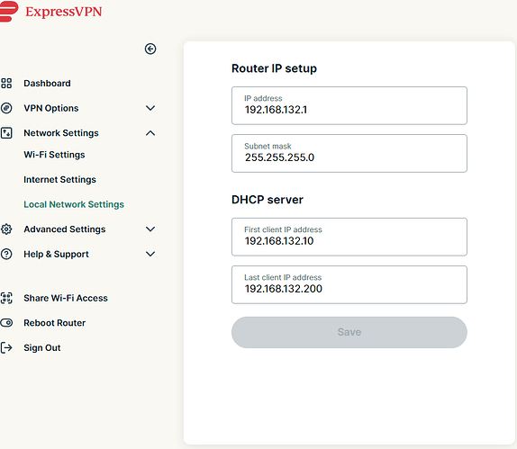

@nevj the VPN is for my entire home network and I could have installed it on individual machines, but since I have so many and limit is 5, I chose to install on the router itself, meaning all traffic on my home network is protected by the VPN (computers, smart tvs, etc.).
I do not use Proton’s VPN as I had already been using ExpressVPN for a few years before they offered one. Protonmail using a bridge is only on a computer wanting to use a desktop app (like Thunderbird) for their secure email and that does not have a VPN involved. Without the bridge, you have to use the web browser for email & calendar as they do not offer a desktop app.
Now I do have a dashboard in a browser tab where I control the on/off switch of the VPN on the router and all the settings we might need to see & use.

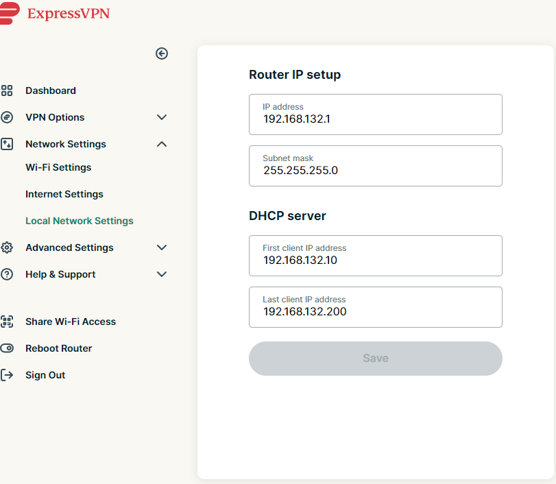

This is the local network settings displayed. Since I know nothing about network routing, I do not know how this compares to what we saw in ip route in terminal on LM or if there are other commands in terminal we can use to compare.
Hope this explains the setup a bit more.

OK,
So what we saw with ip route was correct. I misinterpreted it because I thought only protonmail should use the VPN.
Therefore
  • if you take the VPN away, mega sees the login
  • if you have the VPN present, mega does not see the login… but all your other internet activities go thru thd VPN properly
so you need to ask mega why it rejects a login via VPN since 1 week ago.
