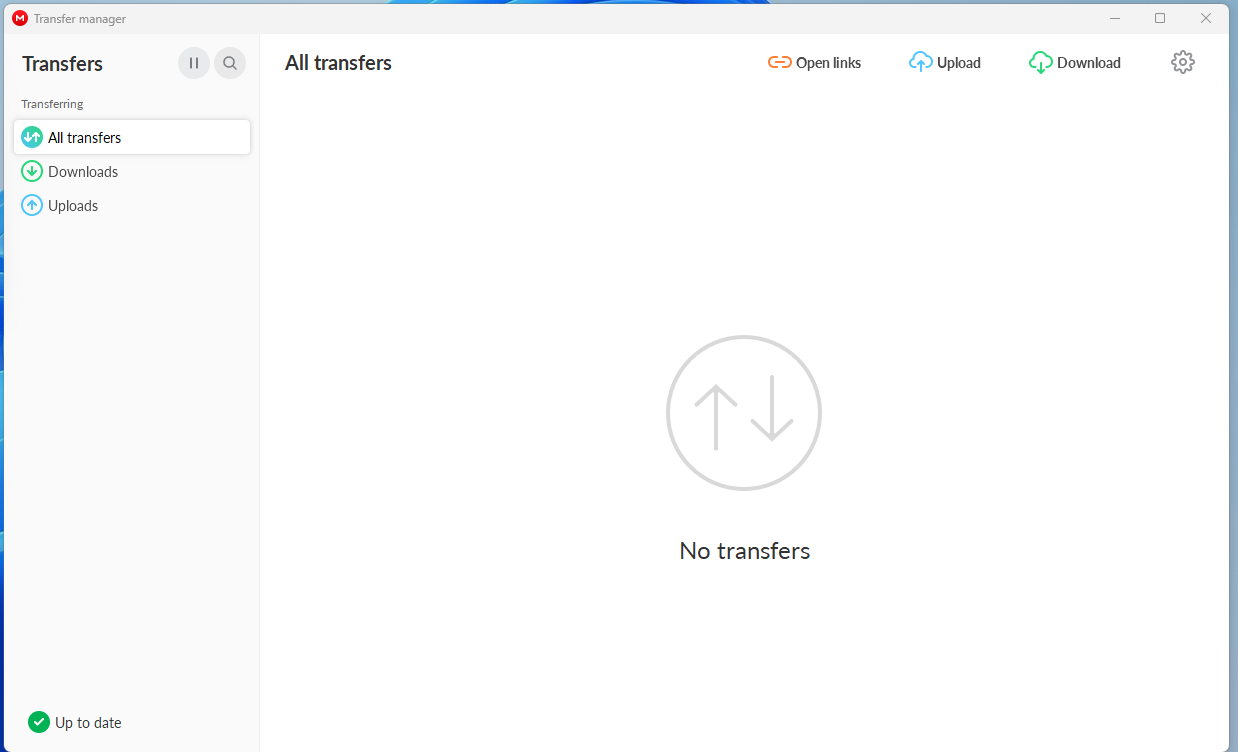

Probably will never use Megasync but here it is on W11 all logged in and ready to use.
So Megasync is working.
Great, we needed to know that

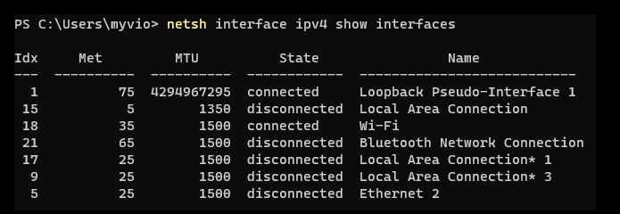

Not sure if this gets same results, but in W11 (with bridge installed) tried:
Hope that helps. Let me know if you need anything else.

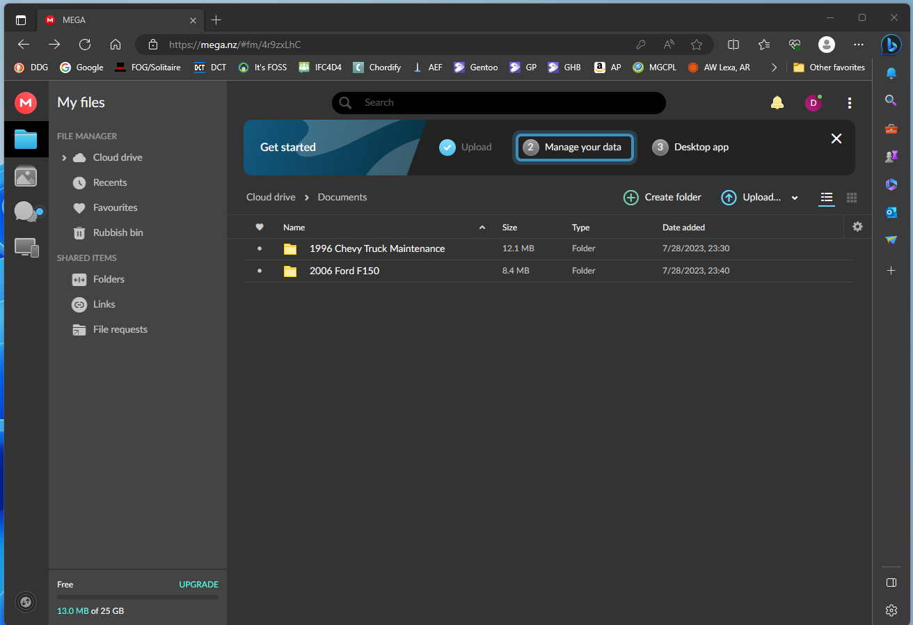

In trying to do all this without Mega working I found I can upload a screenshot but I cannot download (to a different computer), I guess without the app it doesn’t work? I had to open the file in the browser, screenshot it from that computer and then attach here.
