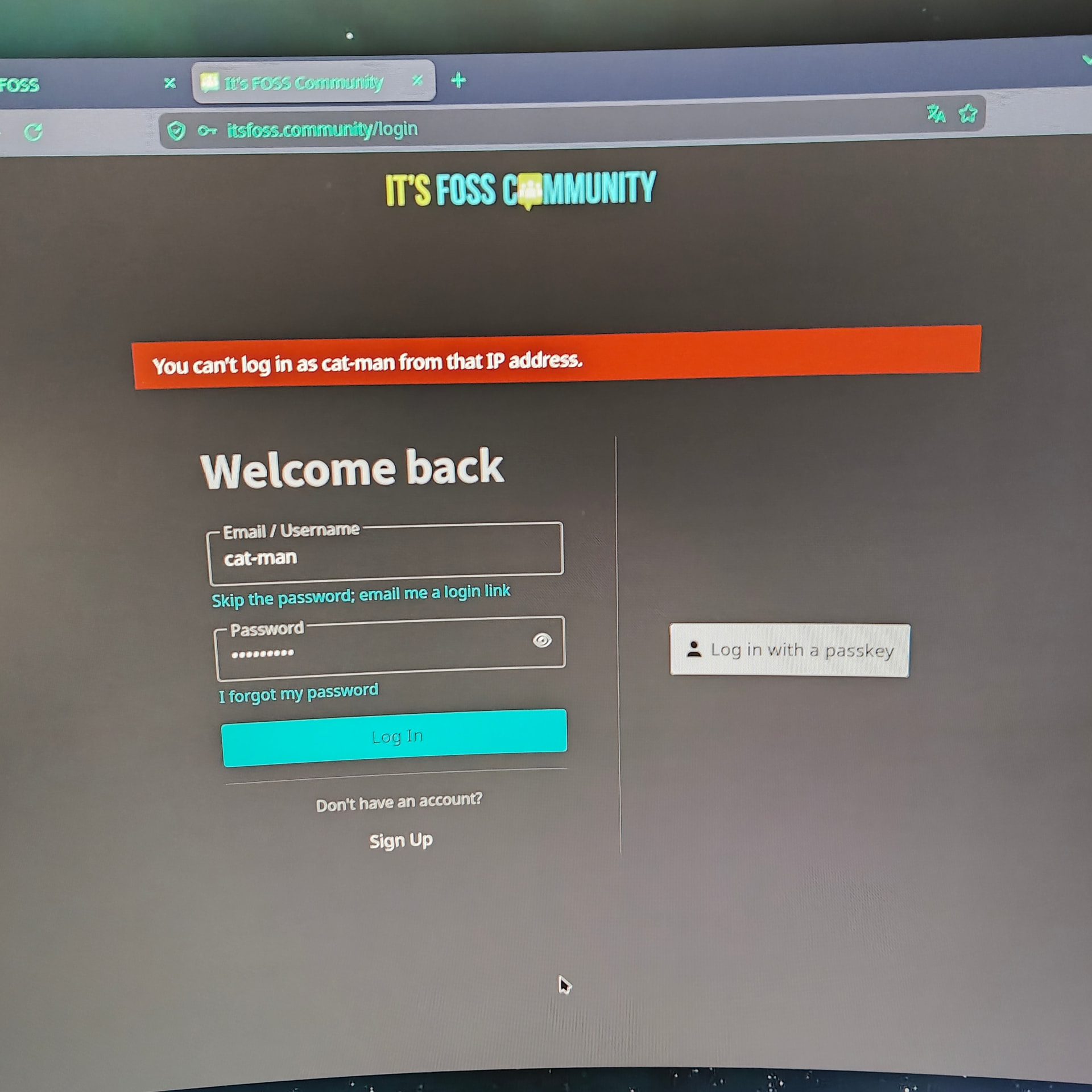

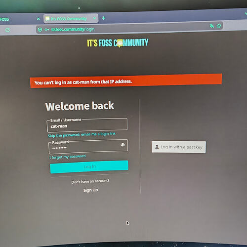

I tried to logg in to its foss on Cachy os with firefox and got this ?
I dont understand why an IP address is involved?
Do you have a misconfigured firewall?
no i have no clue whats up. no i got proton vpn if it can be that and it gives diffrent ip depending wich server im logged into
Close the existing login first.
If you are logged in from Stockholm and then try another login as the same user from Sydney (example), I assume it will be rejected.
ok. i will try that .Thank you
Thank you Alfred it worked :slight_smile:
