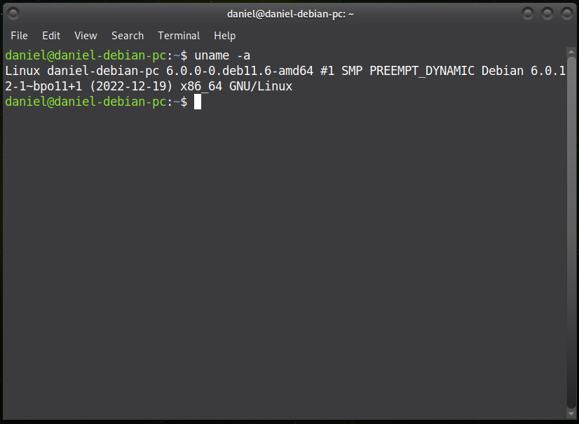

No, it will stay to boot with kernel 6.0
You need to take actions to revert. When rebooting, change to the older kernel in GRUB menu. Then after remove the packages of kernel 6.0.
Installing/removing kernel packages automatically execute update-grub as well, so you don’t need to do it manually.
After you removed them via apt remove, it will boot the 5.10 again. Maybe do an apt autoremove just to cleanup unnecessary packages.

It running well and am using it at this moment. When I first started 6.0, had to edit the advanced grub entry and find the 6.0 vmlinuz, did an F10 booted 6.0 from the menu. Are backports using Debian testing?
My understanding is that they are basically testing, but carefully screened to make sure they are compatable with stable
Sound like I can try 6.0.0.0. Thanks for trying it . Its fun learning new useful stuff. It is good of Laszlo to share his Debian expertise.

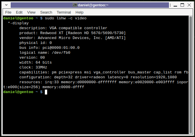

@nevj
I really cannot duplicate your graphics card issue, since I am not running your RX6400.
This is the latest lshw from a new (overnight) Gentoo install. Of course, it only proves that the 5.15.80 kernel supports the Radeon 5670 with the radeon driver, it may also support the new amdgpu AMD driver. Not saying Gentoo is right for you, or for anyone, but it just might help.
It says I need to download newer firmware.
