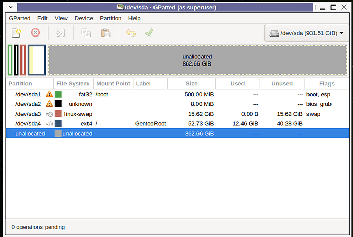

This is my latest install of Gentoo on a SSD GPT disk, even with just 8GB of ram it really flies.
It is not hard, but it is satisfying, but we need to take this to a new thread or to private message. I can usually start a Gentoo install, in the evening and get it to the CLI and finish the next day or next evening. The CLI is the most important.

It first asked which disk to write grub on, and it offered sda, sdb, or eksewhere.
I chose elsewhere, then it asked me to enter something. I entered nothing , and pressed the key to go on, and it installed grub I dont know where, but I suspect in the EFI partition of one disk.
When I cleanup this mess, do you think I should use Legacy or EFI Compatable boot setting? I need to be consistent. Some distros, eg Solus and Clear Linux, seem to expect EFI, so maybe that is the best choice.
I think at the moment I may have grub installed in both the bios-grub partition and the EFI system partition, at least on one disk. Nothing actually wrong with that, But I need to understand what is there and how to control it.
I have actually experimented with making USB drives bootable by both legacy and EFI. You just write grub on them twice in 2 places. There has to be some distro that controls each copy of grub. I couLd do that on the hard disks, or maybe I already accidentally have it! It will boot with either the legacy or efi compatable setting.
I still have my Previous Debian. I did not install on top of it. I used a different partition.
All my distros and data are intact. I just made a mess of the boot system. At worst I can erase both the EFI system partitions, do
grub-install --target= i386pc /dev/sda
from Void
and I should have a pure legacy boot system on sda.

I did not think you could mix legacy boot with gpt or uefi boot, gpt, as for as I know requires uefi boot. Now you can run a gpt disk, in legacy boot, as long as it is not a boot drive. Now one can do an mbr disc, with at least one primary boot partition and a extended partition, broken up in several partitions.
That is why I have chosen gpt and uefi boot on this machine, it is also a learning expereience.
