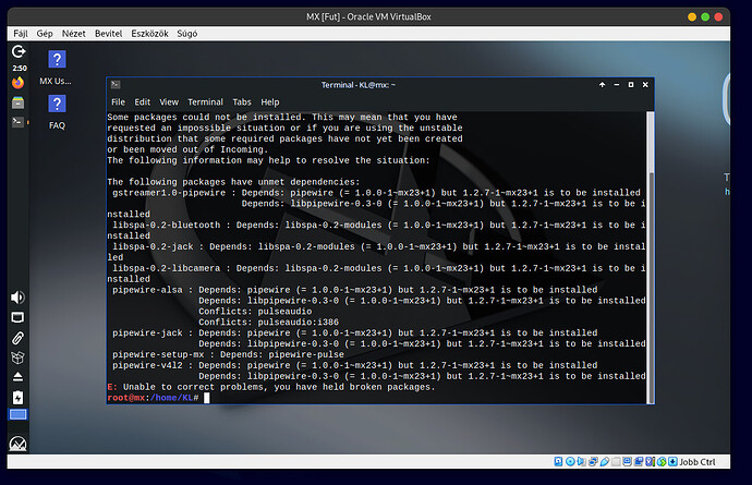

I reproduced the dependency mess.
I enabled MX test repo.
Installed PW from there using apt install pipewire -t mx

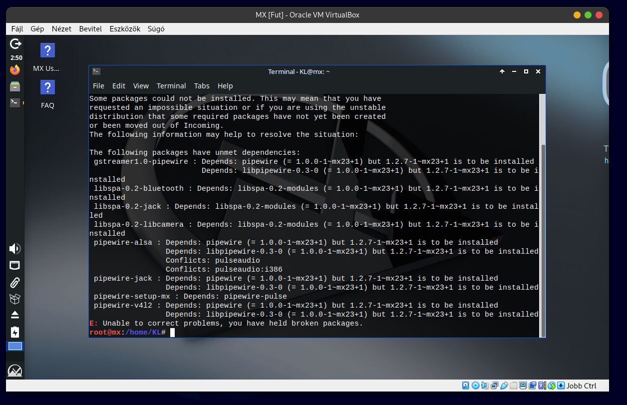

Now if I want to install that pw setp package:
Dose that look familiar?
:star_struck:
Now let’s see how I can solve this…

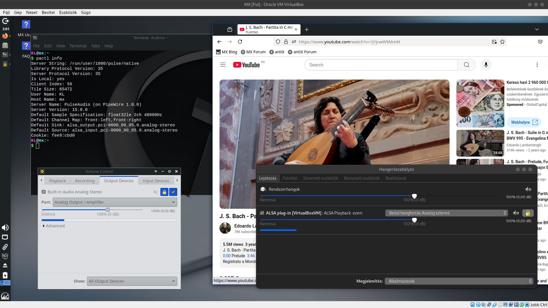

I’m brave, because nothing to loose in that VM.
So choosed to install, then reboot, and
it works…

dpkg: pipewire-audio: dependency problems, but removing anyway as you requested:
 gnome-settings-daemon depends on pipewire-audio | pulseaudio; however:
  Package pipewire-audio is to be removed.
  Package pulseaudio is not installed.
Removing pipewire-audio (1.0.0-1~mx23+1) ...
Removing pipewire-alsa:amd64 (1.0.0-1~mx23+1) ...
Selecting previously unselected package pulseaudio.
(Reading database ... 494628 files and directories currently installed.)
Preparing to unpack .../pulseaudio_16.1+dfsg1-2+b1_amd64.deb ...
Unpacking pulseaudio (16.1+dfsg1-2+b1) ...
Setting up pulseaudio (16.1+dfsg1-2+b1) ...
Created symlink /etc/systemd/user/default.target.wants/pulseaudio.service → /usr/lib/systemd/user/pu
lseaudio.service.
Created symlink /etc/systemd/user/sockets.target.wants/pulseaudio.socket → /usr/lib/systemd/user/pul
seaudio.socket.
insserv: warning: could not find all dependencies for $dbus
insserv: script etesync-dav.service is broken: incomplete LSB comment.
insserv: missing `Provides:' entry: please add.
insserv: missing `Required-Start:' entry: please add even if empty.
insserv: missing `Required-Stop:'  entry: please add even if empty.
insserv: missing `Default-Start:'  entry: please add even if empty.
insserv: missing `Default-Stop:'   entry: please add even if empty.
insserv: Default-Start undefined, assuming empty start runlevel(s) for script `etesync-dav.service'
insserv: Default-Stop  undefined, assuming empty stop runlevel(s) for script `etesync-dav.service'
Processing triggers for man-db (2.11.2-2) ...
Processing triggers for dbus (1.14.10-1~deb12u1) ...
Of course I am back in sysD now so output is bit different and I never finished fixing my calendar script, so ignore that.
What was reinstalling to do? I rebooted, still no sound.
It was supposed to clear the config files of anything BT might have done.
You may now need to look at the pavu gui and reset things.
Does BT speaker still work ?
What are those warnings?
No. It connects the device, but does not appear in the pavu so that I can select it as the output sound source.
I am rebooting into sysV and see if same there as last time I used it was there.
Did BT sound stop working after the PW reinstall or after the PA reinstall?
Well, to be fair, I did not test it after we did both this afternoon. I can only assume it was the first set of
apt purge pipewire* libspa-0.2* DONE
apt install pipewire-setup-mx DONE
or just now when I purged and reinstalled PA.
Last time I used the BT speaker was last night and it worked fine.
Or maybe changing to systemd?
OK, you are in a bigger mess now… no speakers at all unless you use a live usb.
What do we do to recover this?
Did you look at pavucontrol settings?
Pavucontrol is where you get into the mixer tabs and that is where you select the outputs like speakers or headphones. Normally when i connect my BT speaker, I get a notification that it is connected, and then I click pavucontrol and select that speaker by name. Tried 3x and it never appeared in pavu even though MX reported it connected.
