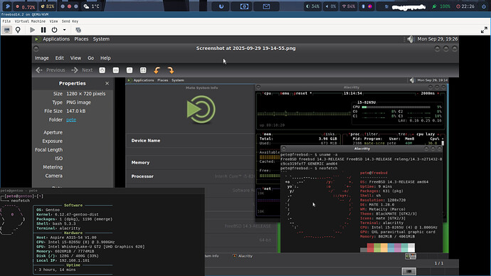

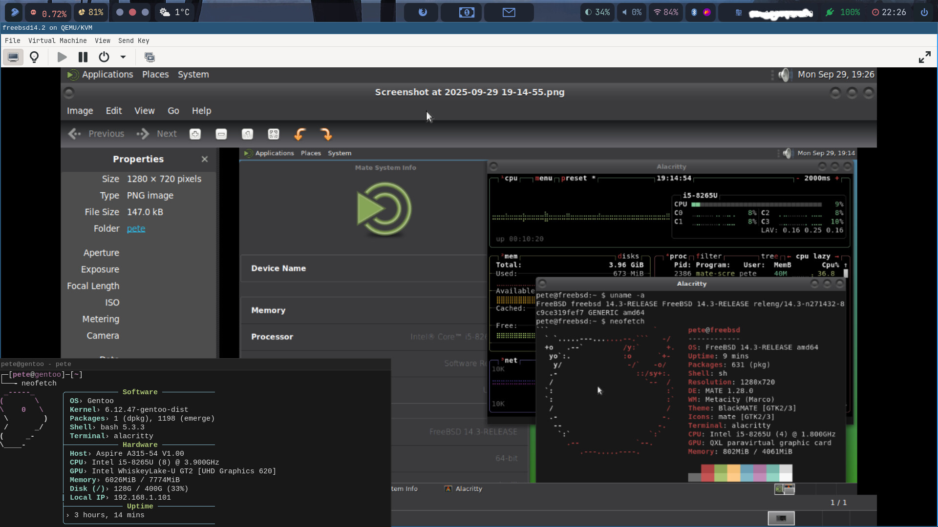

my laptop with i5-8th gen with 8GiB RAM is a bit hot at the moment but the FreeBSD inside Qemu is happily idling running Mate on Xorg. Couldn’t get Sway+Wayland running yet. I haven’t tried a BSD system for a while, maybe 10 years since. It’s a bit strange to find out some commands are not the same but nice to learn more about BSD. Now I need some tips what to learn/try/anything with BSD. I will try ports next, used only pkg install till now. I do have a normal user with sudo privileges atm.
screenshot: full screen BSD with my host’s neofetch info on bottom left corner

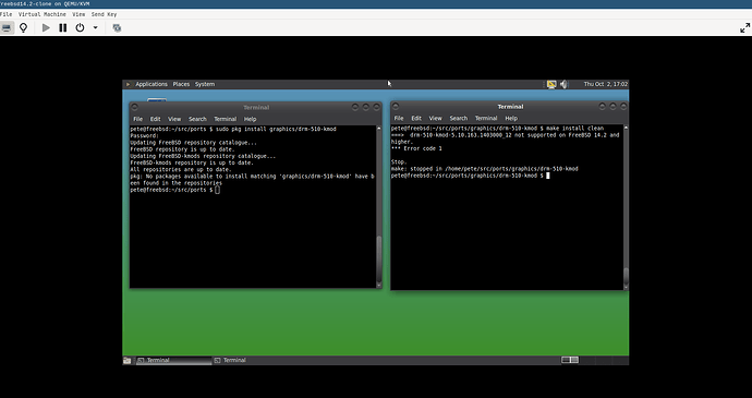

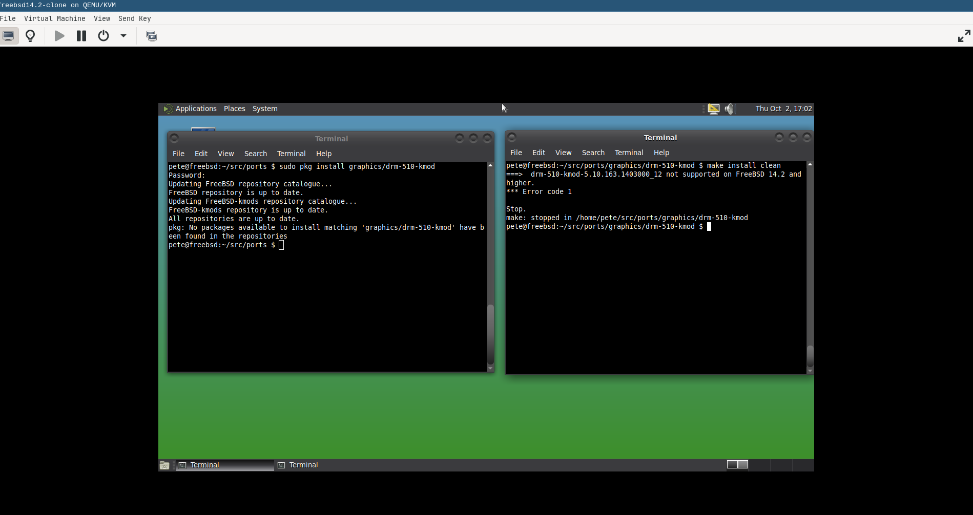

Thanks! I’m on Xorg. I tried to install graphics/drm-510-kmod. See the pic. I tried with pkg install and with ports. It seems it’s not available for the FreeBSD 14.3.
Try make on its own, then if it works make install, then make clean
I think this is BSD make, not gmake.
If the template is there in the ports directory, it should make it.?
If they have really abandoned it, then there must be another newer method replacing it? Those links must all be out of date… How do we find what the new replacement method is? Try the Freebsd Handbook… hopefully it is up to date.

I tested to build all of the drm-XX-kmods there’s in /usr/ports/graphics (one at a time, reboot, no change, make deinstall, next one) but no luck. The drm-510-kmod is for older FreeBSD versions and won’t build, others did build but still only VGA. There’s drm-515-kmod, drm-61-kmod, drm-66-kmod, drm-kmod and drm-latest-kmod (which didn’t build).
OK , my fears are confirmed. We went off on a wrong track… sorry.
Forget about configuring graphics in Freebsd… that is irrelevant in a VM, it does not drive the qemu display window, qemu drives it.
