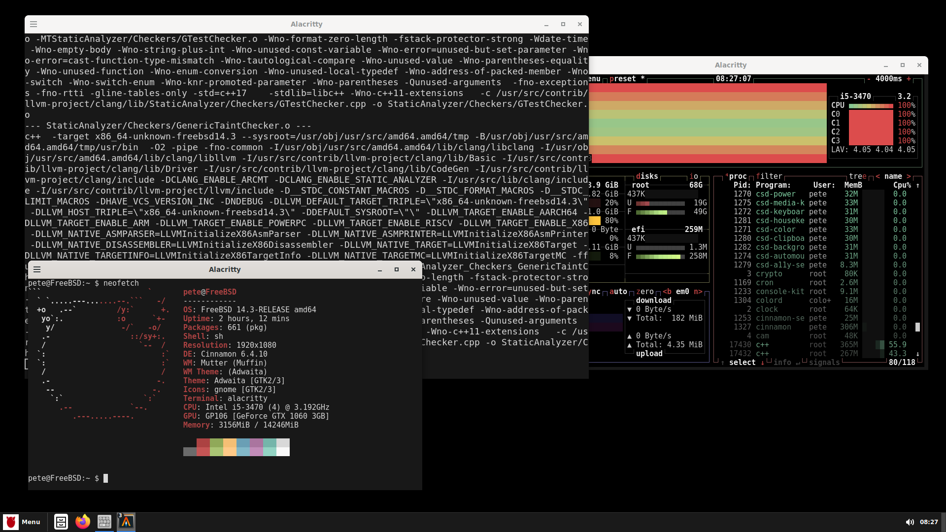

I couldn’t get FreeBSD (or the other BSDs) working properly inside Qemu. So I installed it to my HTPC’s SSD. I have X11 working and installing the Cinnamon desktop at the moment. It takes a while (LOL) because I use ports. There’s big packages to build. The difference with Portage is that you need to manually enable / disable what the package is building. So I need to monitor the build or otherwise it just waits for your input if you would like to build the docs or not with every package Cinnamon has as an dependency. Gentoo’s way is so much easier. I think we can close this thread and I’ll post a new one when my FreeBSD on hardware is working

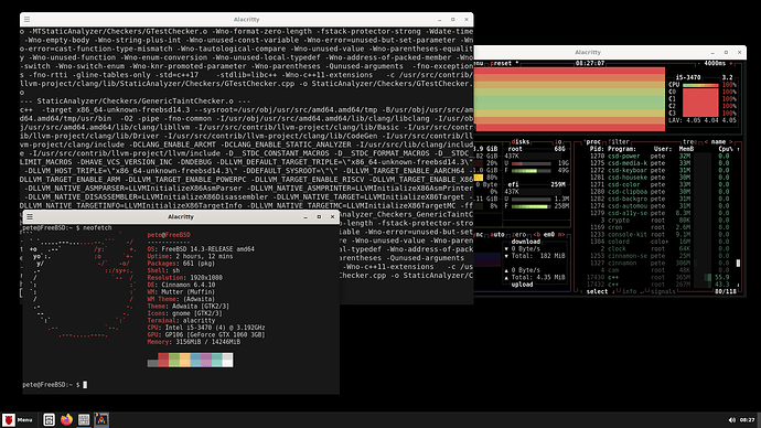

FreeBSD running on my computer and all is fine! So it must be some config issue with qemu. Anyways, happy to play with it. I’m currently on Cinnamon, installed with ports. Firefox is installed with pkg install at the moment.

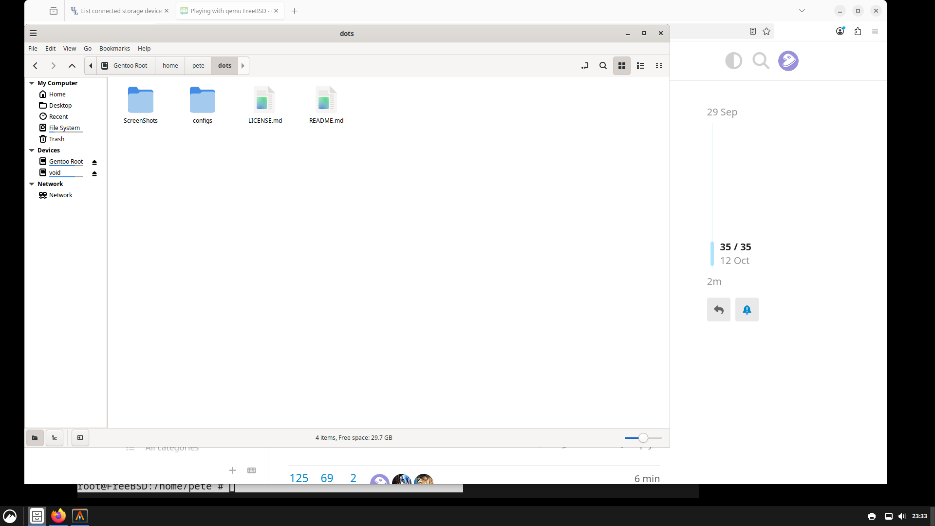

I just found out that lsblk is available for FreeBSD and it “sees” my ext4 partitions:
root@FreeBSD:/home/pete # pkg install lsblk
Updating FreeBSD repository catalogue...
FreeBSD repository is up to date.
Updating FreeBSD-kmods repository catalogue...
FreeBSD-kmods repository is up to date.
All repositories are up to date.
The following 1 package(s) will be affected (of 0 checked):
New packages to be INSTALLED:
	lsblk: 4.0 [FreeBSD]
Number of packages to be installed: 1
7 KiB to be downloaded.
Proceed with this action? [y/N]: y
[1/1] Fetching lsblk-4.0.pkg: 100%    7 KiB   7.1kB/s    00:01
Checking integrity... done (0 conflicting)
[1/1] Installing lsblk-4.0...
[1/1] Extracting lsblk-4.0: 100%
root@FreeBSD:/home/pete # lsblk
DEVICE         MAJ:MIN SIZE TYPE                                    LABEL MOUNT
ada0             0:123 233G GPT                                         - -
  ada0p1         0:125 1.0G efi                  gpt/EFI System Partition -
  ada0p2         0:127  12G linux-data                           gpt/Swap -
  ada0p4         0:131 157G linux-data                     gpt/linux-data /media/Gentoo_Root
  ada0p3         0:129  63G linux-data                     gpt/linux-data /media/void
  <FREE>         -:-   168K -                                           - -
ada1             0:151 238G GPT                                         - -
  ada1p1         0:161 260M efi                                   gpt/efi /boot/efi
  ada1p2         0:163 238G freebsd-ufs                   gpt/freebsd-ufs /
  <FREE>         -:-   486M -                                           - -
md99             2:56  4.0G freebsd-swap                                - SWAP
and I can access my Gentoo / Void files from Nemo also:
Yes, you can mount them as ext2fs in NetBSD, as long as they are not larger than the ext2 partition size limit. You might be able to read, but dont try writing… it could screw your filesystem. I would mount them ‘ro’.
