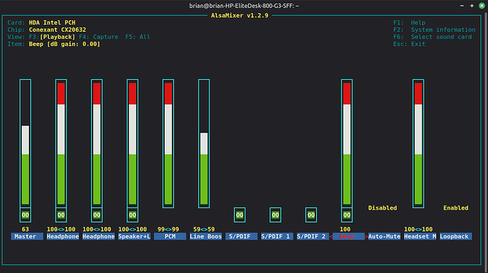

I always unmute everything in alsamixer after any changes and set all to max.
Hi Bruno,
I hope you’re well.
Thanks for sending a screenshot of alsamixer - a picture is worth a thousand words.
From what I can see, you don’t have MIC in alsamixer, which could mean that your webcam’s microphone isn’t being detected by the system.

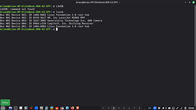

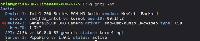

If you haven’t already, you can run the commands:

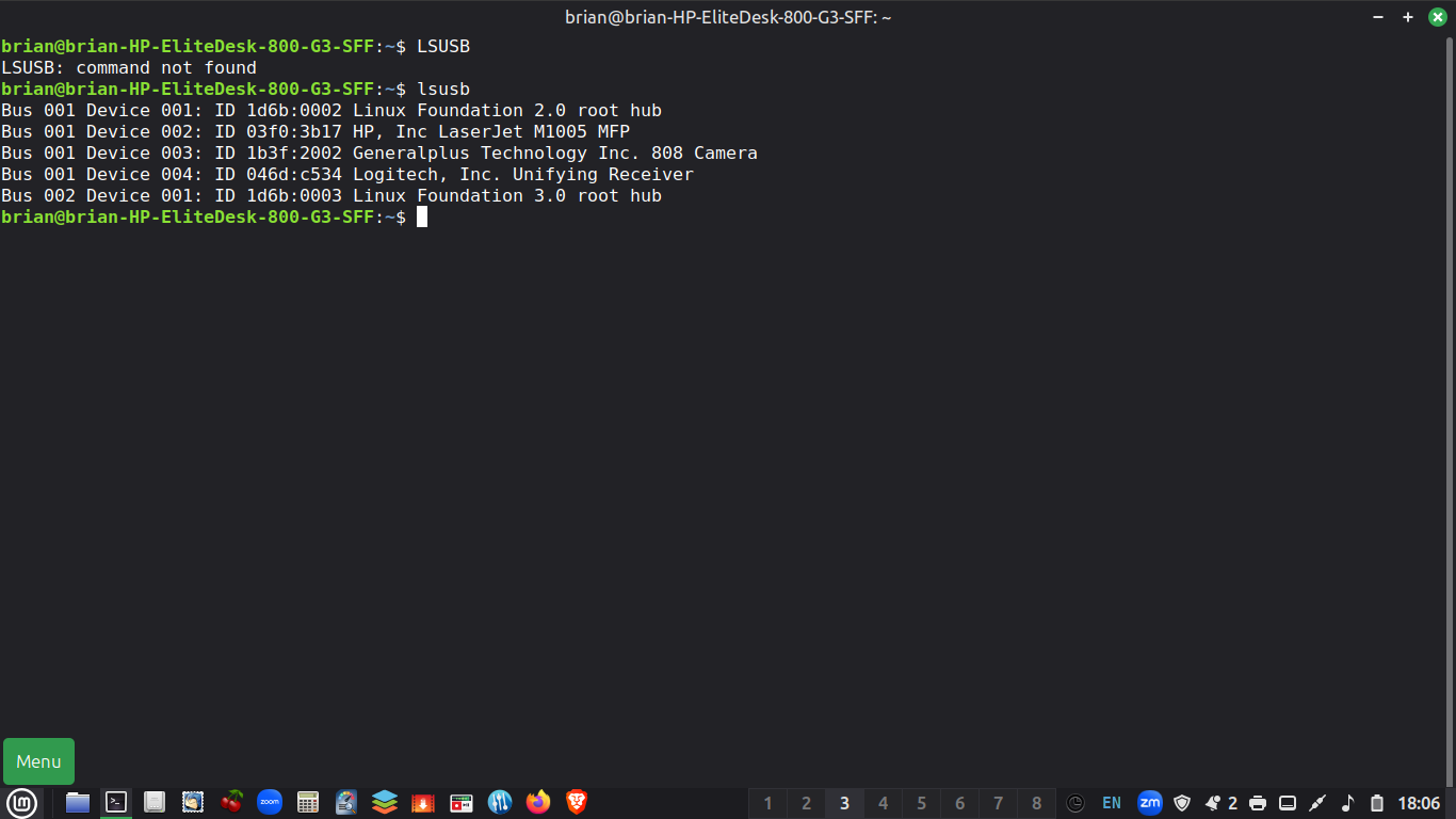

lsusb

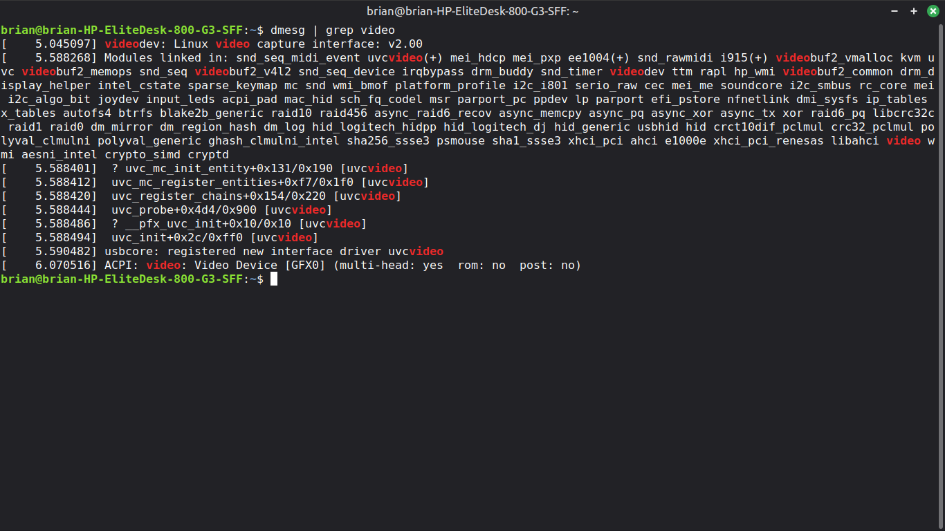

dmesg | grep video

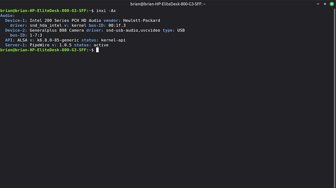

Inxi -Ax
Post the results here.

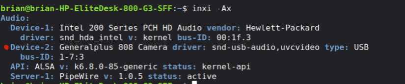

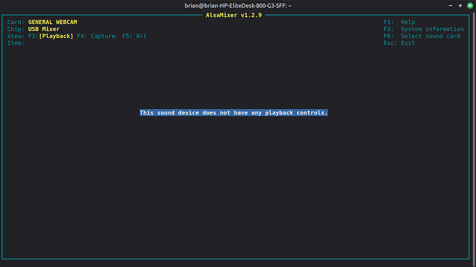

As far as I can tell, the camera’s audio hardware is being detected:
Can you do one more test?

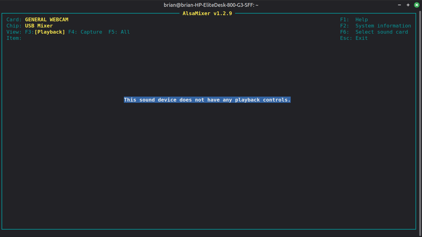

In the screenshot you sent from alsamixer, you sent it from the HDA Intel PCH card.
Can you open alsamixer again, press F6 and see if you have any other devices? If you do, can you select it and send a new printscreen?
Thank you
only one soundcard, and the webcam.
