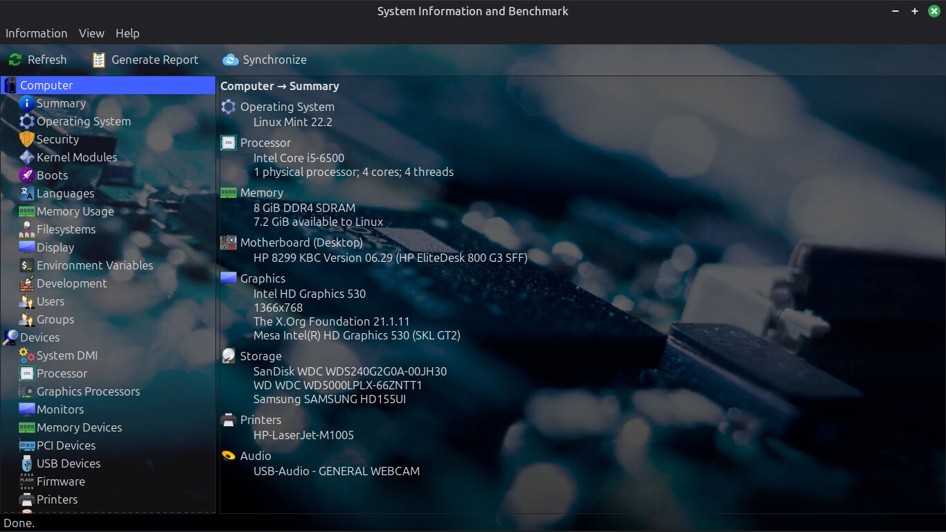

Bruno,
Thanks for the screenshot of the system info.
I will try to help as best I can and to the best of my knowledge, but my approach may seem simplistic, but I can’t do it any other way.

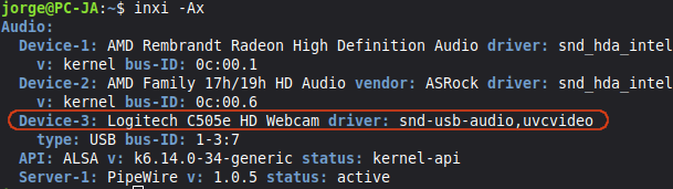

From what I can see in the screenshot you posted, it looks like the webcam is recognized as USB-Audio:
As I said earlier, I believe that the camera’s audio hardware is being detected.
I connected my USB webcam, ran the command inxi -Ax, and verified that I have the same drivers as you for the webcam:

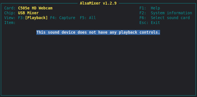

If I try to view the audio source in alsamixer, I get the same information as you:

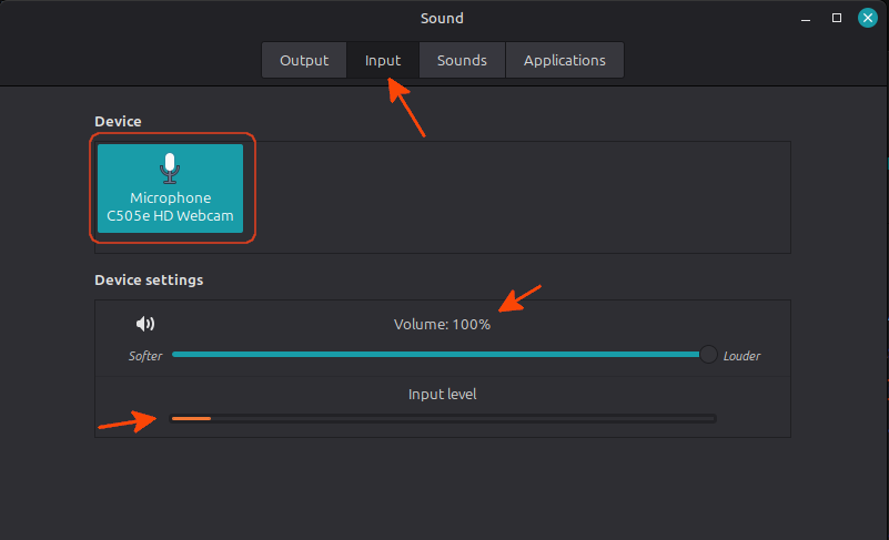

I need you to do a test, please:

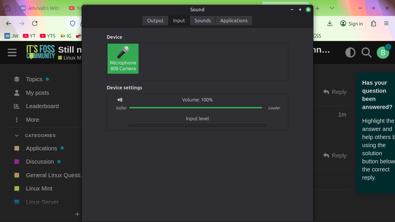

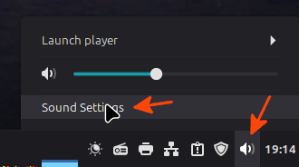

  • With your webcam on, click on the speaker icon on the panel next to the clock, then click on Sound Settings:

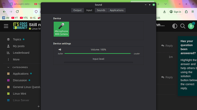

  • In the Sound window that opens, click the Input button and check that you have the Webcam Microphone device. If you do, check that the volume is at 100% and speak a little to see if the Input level bar changes:
For now, I don’t need you to test Zoom.
Please give me your feedback, thanks.
Shows webcam audio but no microphone response at any level.

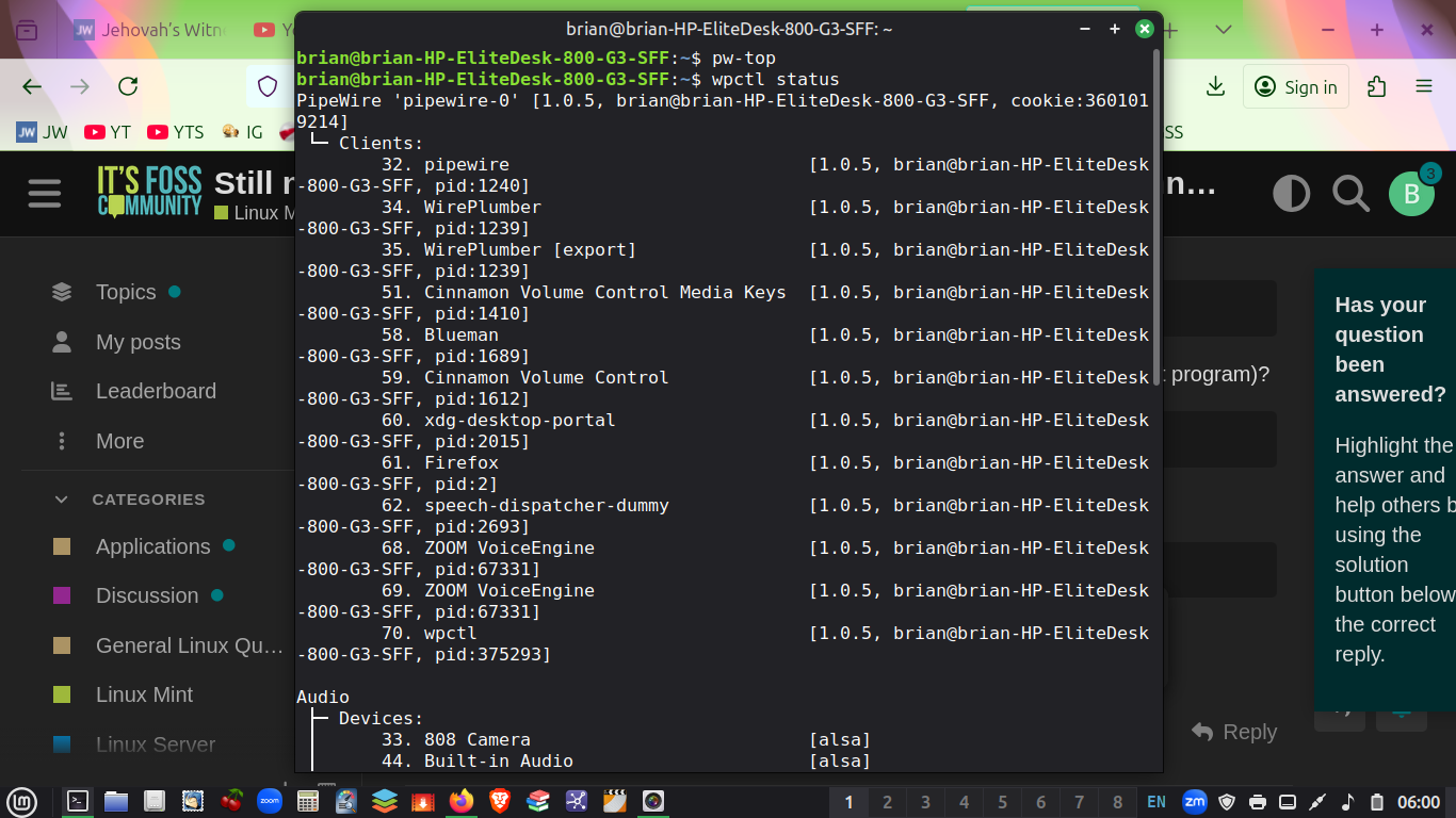

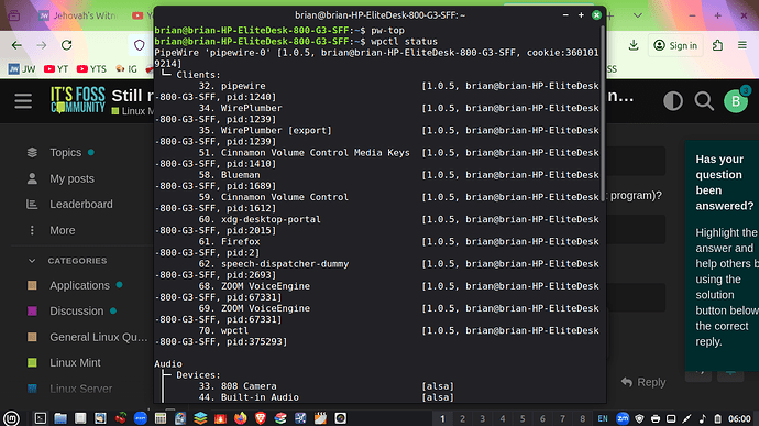

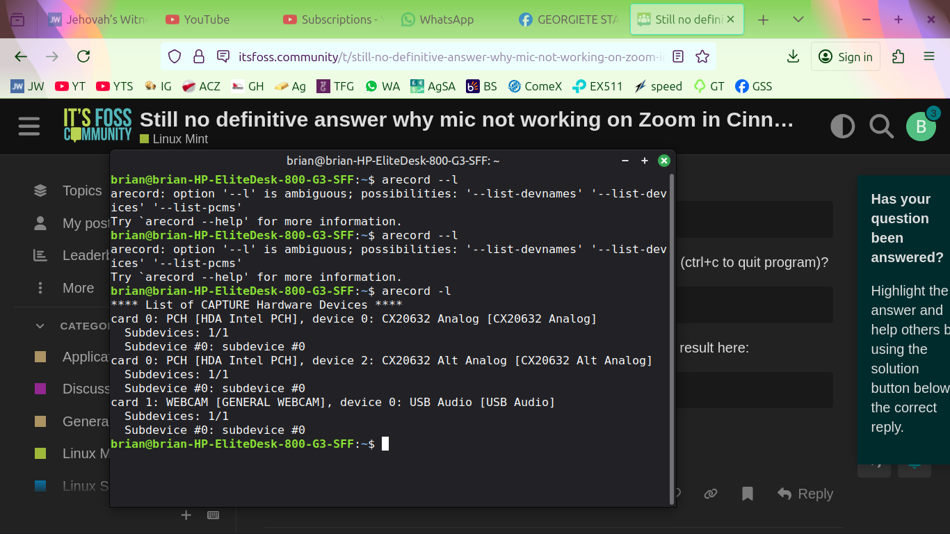

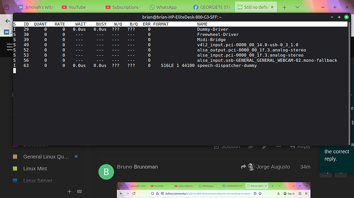

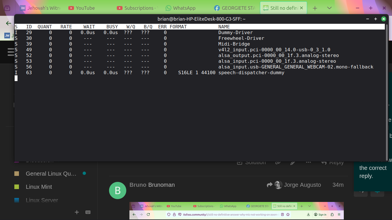

Bruno,
Can you run the following command and post theresult?
arecord -l

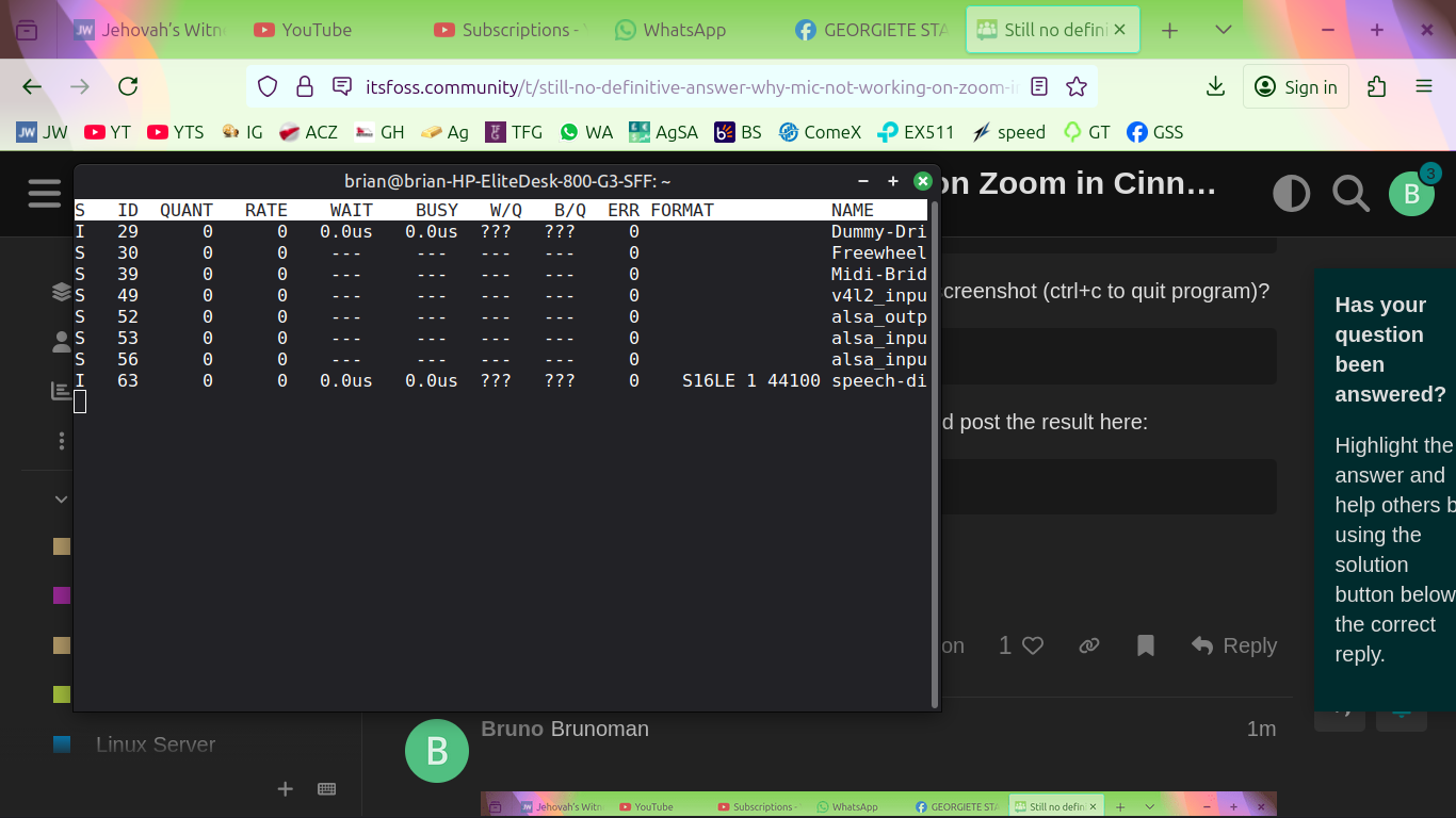

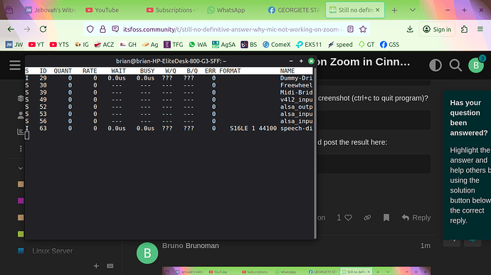

Can you run the following command and post a screenshot (ctrl+c to quit program)?
pw-top

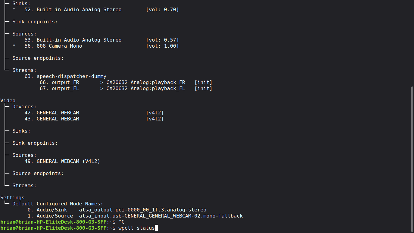

If possible, please run the following command and post the result here:
wpctl status
Hi Jorge, sorry for delay, it is 6:00am here now. i was told that 81 yr olds need their ‘beauty sleep’:joy:
First result I did not have screen wide enough to show all results. new screenshot here.

Thanks for the screenshots. I’ll take a look and let you know what I think.
