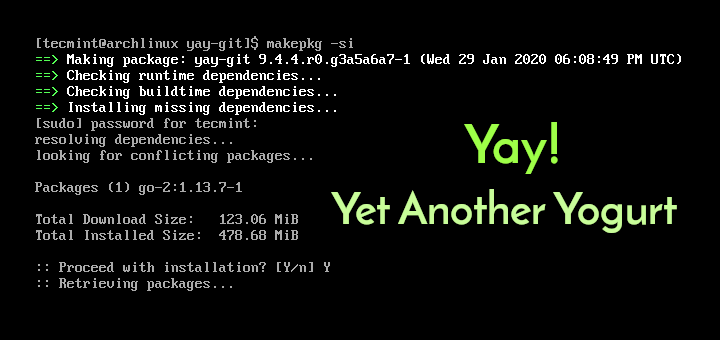

I was wrong about the Arch AUR helper YAY!!! I just installed the YAY helper in my Arch VM, will try Artix later on!!! I used this website for reference!!!

Most packages can be obtained through normal repositories!!! I used yay to install gparted and the Arch AUR offers, something like 80000 packages!!! Still not sure on where and how Artix will use AUR.

It is, I just wanted to try yay!!!

I have been building Artix today!!! First thing I did was to install the yay helper for AUR, and to get Artix or Arch built, with the packages I need, I had to install some packages from the AUR, especially packages concerning fonts.
