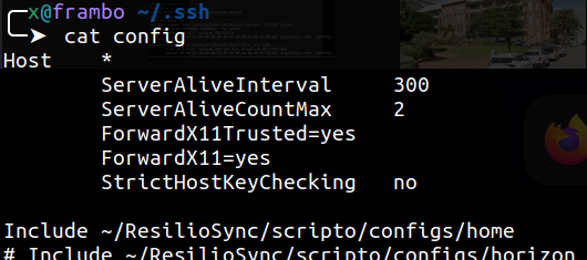

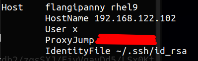

I configured “ProxyJump” in my ~/.ssh/config (it’s actually an “include” argument in my ~/.ssh/config)
Not concerned about sharing the NAT VLAN my kvm / virsh is using… But will continue to redact my home LAN details…
ProxyJump setting is the IP address of the machine hosting KVM / virsh et cetera - i.e. my AMD desktop running Ubuntu 24.04…
It works - there’s a fair bit of a lag (noticeable - I’ve used ProxyJump before and it was almost transparent and instantaneous) - but it works…
e.g. from my Pi4 running Raspbian - I can ssh to the RHEL 9 VM hosted on my desktop machine’s KVM / virsh… There’s about 25-35 seconds delay - that’s noticeable :
