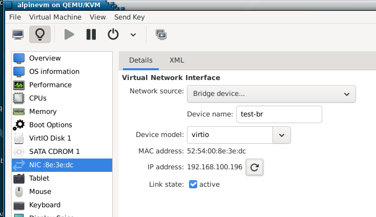

  • Start the VM guest, and in NIC menu setup
  • then nothing works… I cant even ping host from guest or vice-versa
  • The VM definitely knows about the bridge
# virsh domiflist alpinevm
 Interface   Type     Source    Model    MAC
 vnet0       bridge   test-br   virtio   52:54:00:8e:3e:dc
but it cant communicate via it?
OK, I give up for now.
Clearly I dont know enough about bridges or routing or something?
