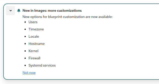

OK - the first qcow2 image I downloaded of RHEL 10 didn’t have a password - or user account - that I knew of - I don’t see the point…
anyway - I tried RHEL’s cloud image builder - it’s a bit like the OpenSuse image builder…
And got it to work - so easy too! Then register with RHN with my Developer License credentials… and I’m cooking with gas, or installing with dnf :smiley:
Why would you use a qcow2 image rather than download an iso and install it.?
Is it an image of an installed system? … or is it like a live iso?
'cause you save a bucketload of time…
It’s a prebuilt image with a bootable O/S ready to rock’n’roll…
But, you dont have any timezone or locale or user login or custom partitions? Does it network?
Building (or “composing”) an image - you can actually set the locale, timezone, language, keyboard etc during the image build… But you always change that later on… It also lets you create a user (but enforces 2 char minimum for username) and push your SSH public key into the image.
T
here is an option to set custom partitions too - but I just go with defaults… Which probably means I can’t apply a CIS1 or CIS2 hardening profile - but I don’t want that stuff anyway… Default is a 10 GB “/” with everything hosted on that… I can work with that… If I want to add storage later - I know how to do that…
And it’s networked (DHCP) by default.
It’s not really much different than getting an RPi image of Raspbian for a Pi device…
With the RPi imager tool (there’s Mac, Windows and Linux versions) you can do a few things before the image gets written to the media (e.g. SD-Card, USB drive) like set the WiFi country, create a user, insert your SSH public key.

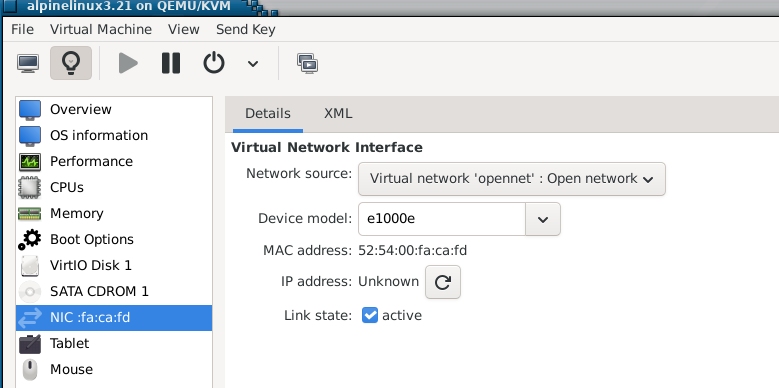

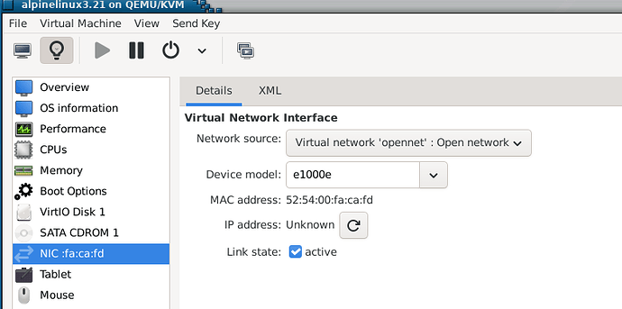

OK, you got there with a bridge.
I can do it without a bridge.
I selected “open network”
Apply that, and do nothing in the host
  • guest can ping host
  • host can ping guest.
  • guest can ping anyting on my private local net (192.168.32.0) via port enp16s0 on the host
  • other machine on my private net can ping the host , but not the guest. This is fixed by providing a route in that private net machine
    `ip route add default via 192.168.32.6’ ( the hosts IP on the local net)
    The private net machine can now ping the guest.
  • if I try to ping something on the internet from the guest, it does the DNS lookup and gets the IP, but does not connect?
    I dont understand that?
Not quite full marks , but I am trying.
I’ve never messed with open network, but my understanding is that you must manually set up routing and firewall rules to allow traffic from the VM to the internet. So possibly the problem is the routing or firewall configuration on the host. Getting into things I haven’t really ever looked at- but I think those might be different protocols -Standard DNS queries use UDP/53 vs Ping uses ICMP vs Web Browsing TCP
Thank you. I will see what the firewall situation is in the host. It will be whatever the default is for Void Linux.
The host has a default route, to the internet connection. Any packet it cant route should go to the internet… but it is not routing the packets sourced from the VM? Maybe I need to define a gateway?
All I am trying to achieve is to learn how to do things without a bridge, because then I may be able to understand how a bridge works.
I got a similar result with NAT mode…
And my work around for “another machine on my private net” (using NAT) to get to the guest VM - use ProxyJump argument in ~/.ssh/config… But that was cumbersome…
Proper host based bridge mode works best - the best of both worlds… and very similar (end result) to bridged network in VirtualBox - but better - 'cause it’s KVM and my kernel is already hypervisor aware…
And I’m fortunate in that I can use a 2nd gigabit NIC for the bridge…
