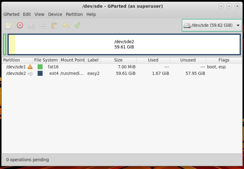

plugged in the USB stick on which EasyOS is successfully installed (/dev/sdg)
/dev/sdg has two partitions:
1.) /dev/sdg1: EFI (FAT-12/16/32) (Bootable): 7,3 MB
2.) Linux ext4 : 63 GB (61 GB free)
sudo dd if=/dev/sdg1 of=./2BOOTSYSTEM.img # went well
That left me with the 2nd partition. Hmm

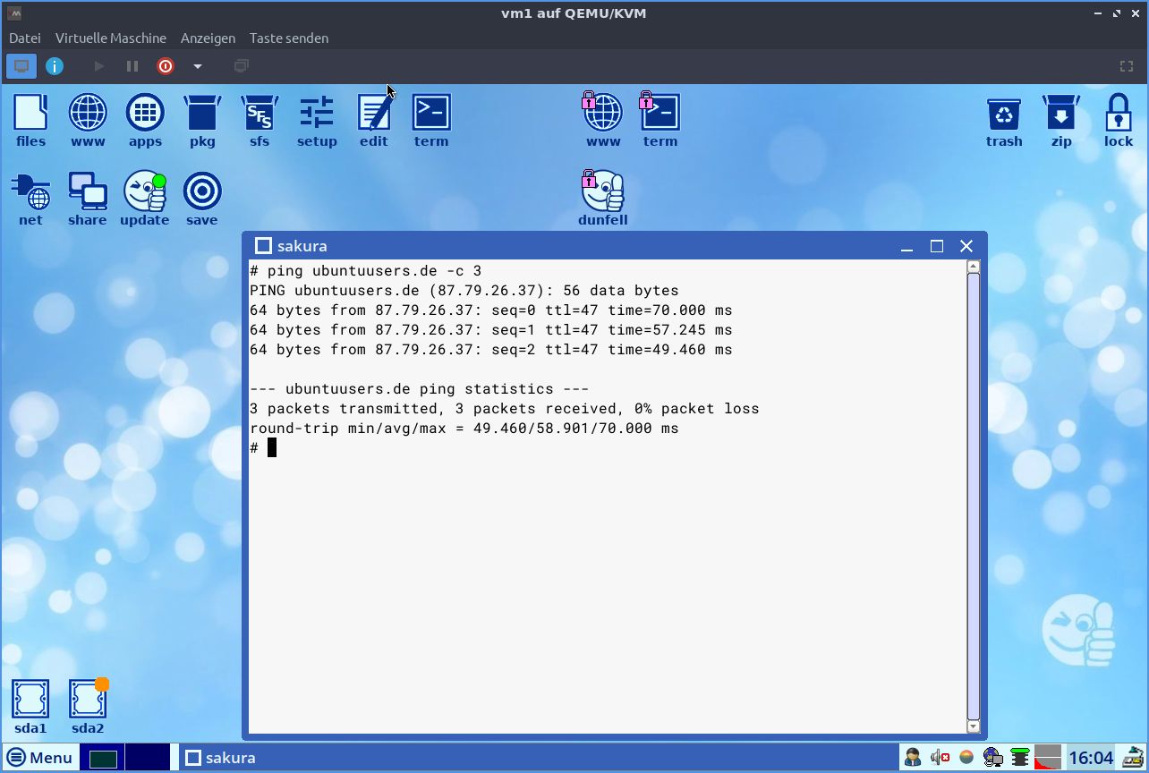

I applied that new img as an existing drive image in virt-manger and the installation succeeeded.
EasyOS is running and I even have an running internet connection.
