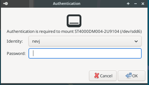

This problem of using Thunar in Xfce to mount internal disk partitions is still with me.
After a great deal of mucking around spread over more than a month, I have done 2 things
1. Create a polkit rule for internal disks.
cd /etc/polkit-1
mkdir localentry
cd localentry
mkdir 50-local.d
cd 50-local.d
vi 55-myconf.pkla
add the following lines
Allow User to Mount Internal Partition
Identity=unix-user:nevj
Action=org.freedesktop.udisks2.filesystem-mount-system;org.freedesktop.udisks2.filesystem-mount-system-internal
ResultAny=yes
ResultInactive=yes
ResultActive=yes
save
reboot
  1. Install LXPolKit, and set it to autostart
apt install lxpolkit
apt install lxsession
Then use
xfce4-settings-manager
You have to type it at the CLI, it is not in the menus.
You get a GUI… go to Session and Startup → Application Autostart → Add
then add lxpolkit.
It worked at the second try… the first rry complained about failing to write autostart/lxpolkit.desktop… but it did write it ( it is in ~/.config) … and the second try after a reboot worked.
Result:
After those 2 mysterious configs, when I try to mount an internal partition with Thunar ( or with the icon) I get
Which is correct. I can now enter my password , and the filesystem is mounted.
Success! I think I now have an Xfce in antiX which is working well enough to be a daily workplace.

Have you did “ sudo chown -R nevj:nevj /home/nevj “ ?
No, but that is a good idea.
The top level is OK … ie all owned by me.
Do you have any idea why lxpolkit works and polkitd does not .?
Then you are working from root?

lxpolkit listens for polkitd requests and displays your login pop-up!! You are running antx as root!!
No, thunar runs as nevj. It can normally do user mounts.
Another way to do a user mount is udevil mount /dev/sdx … That works, but Thunar did not work until I did those mods?
Have you did “ whoami “ ?
